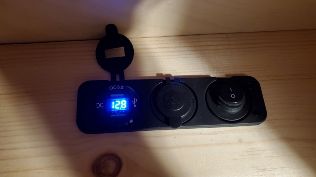

Postby Tom&Shelly » Thu Aug 03, 2023 1:36 pm
terrymorse wrote:Another question about the cigarette lighter connector: How much current can they handle? It seems they are limited to 10 or 15 Amps.
I have a 12v kettle that draws only 10 Amps, and its cigarette lighter connector gets quite hot to the touch. Is there a better choice than the cigarette lighter connector for high-ish current?
That's a good concern. I initially rejected these (lower right) because they couldn't handle the high current draw devices
153425
Here's what they look like taken apart, btw
152991
Instead, I used some rated for higher currents that are commonly sold on Amazon to fit in black bezels along with round USB ports (that are electrically very noisy) and round volt meters.
But, I believe these will work with the new USB-PD chargers, and so I will probably simply replace the ports in our headboards (lower left in the photo above) with these, which was where I originally intended to use them.
