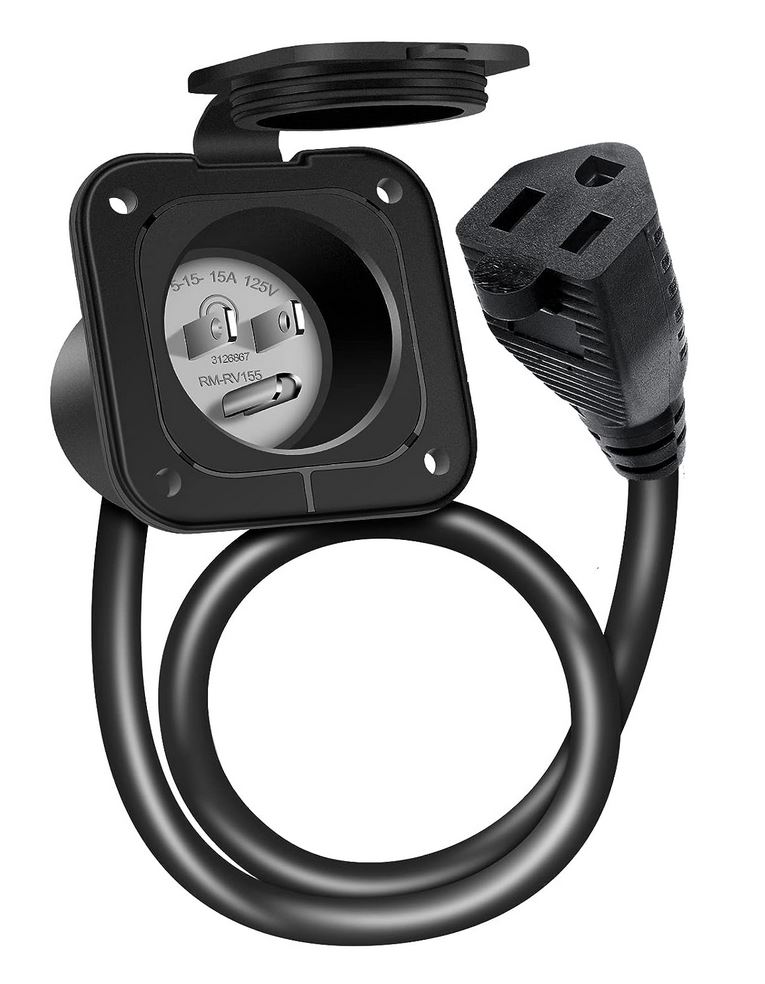

Postby cdnred » Wed Sep 13, 2023 8:10 pm
Decided to order me a 15A plug with a 18" extension. Easier solution for wiring up. Just plug my power bar directly into the extension and good to go. Picked up a 30A male/15A female RV adapter for plugging into campground service..
