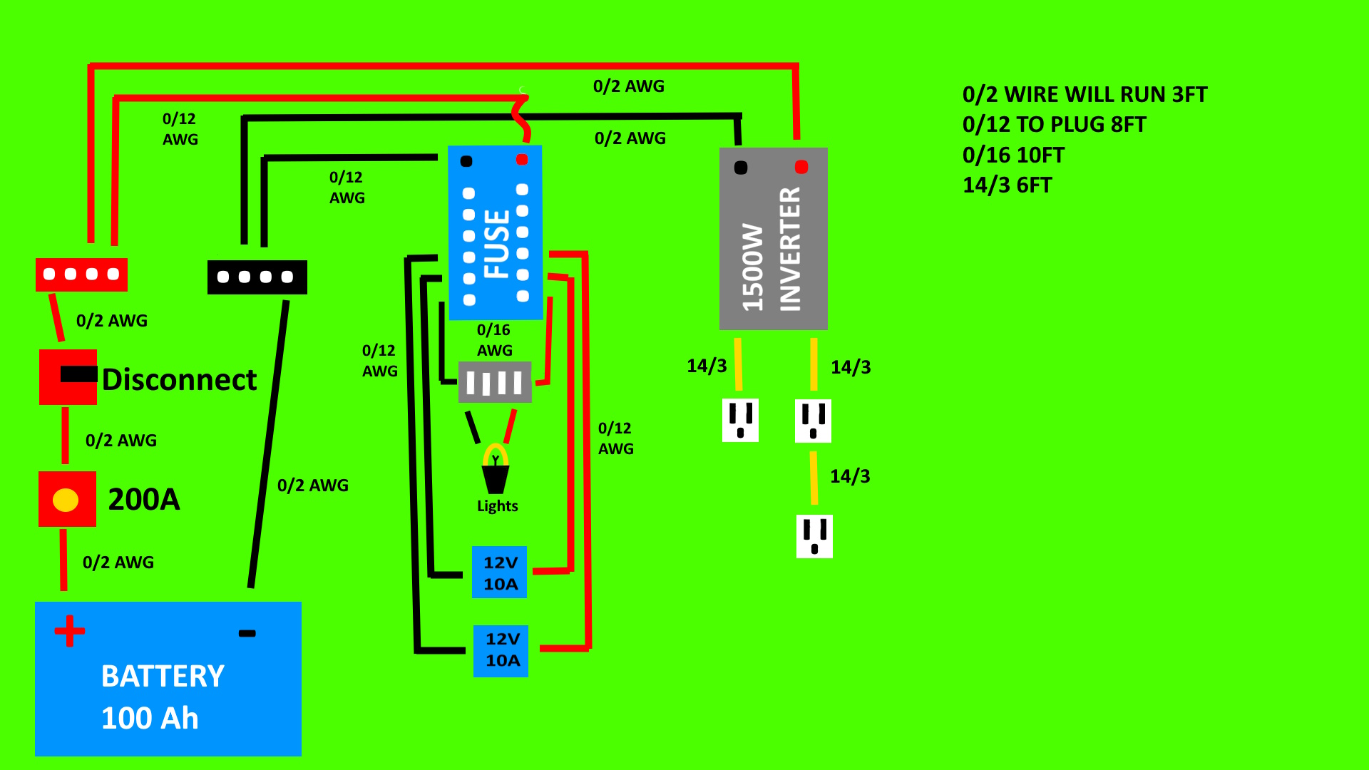

Postby Buddy-and-Missus » Wed Sep 27, 2023 8:18 am
Thanks all, yes we've been thinking about it for quite a while but still am sure we are not thinking of everything lol - so any feedback is greatly appreciated. My husband has a better grasp on the wiring part, and I plan on using an electric cooktop and a small toaster oven both well under 1000W and we plan on using a 1500w inverter. We won't be using AC since we live in a cold climate area and have 2 large windows - that is unless we decide to stray further off the island but I'm doubting it will be any time soon. As for the cooler, for now we are using and icebox but if we upgrade the system I'd still like to have the receptacle in place.
Here's hubby's rough idea.
Buddy-and-Missus
Posts: 124
Joined: Sat Aug 12, 2023 6:45 am
Re: Weatherproof or GFCI?
Postby bdosborn » Wed Sep 27, 2023 10:26 am
A 100A battery is only going to support up to ~1,000 W inverter. You'll want to upgrade to 200A battery if you want to run a 1,500W inverter. You'll want at least a 2,000W inverter if you're going to run an induction cook top.

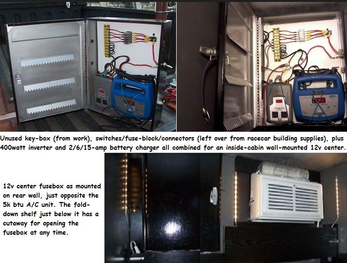

When I was building my trailer (originally for the wife to use, solo camping, to get her out of a leaky tent), I tried to plan for all contingencies (at least where power for A/C, heating, cooking & lights, as well as having a secure, dry place to sleep were concerned). I may have gone overboard a bit (I had to write a user's manual for her to read, but she never used the trailer at all). It was mainlt about the electrical system(s). I have separate 12vdc and 120vac systems, using many fuses, master cut-offs, and circuit breakers on each.
On the 12vdc side, I have the Optima Yellowtop battery in the tongue box (shielded from other equipment and spares in the box, with ventilation), with 4 ga cables run underneath the trailer to a master cut-off switch in the galley (there's also an unattached feed from the generator in the "galley/storage area", in case I choose to use it for direct 12v, instead of 120v, and a separate circuit breaker for the trailer breakaway switch). From the master cut-off, there are 10 gauge wires run inside the cabin to a re-purposed Key storage box 98251
on the rear bulkhead above the rear shelf, with the A/C unit next to it (master A/C switch controlling the A/C, a chassis cooling fan, and a hi-flow axial fan in the exhaust duct).
108161
airconditioner next to 12v control box.JPG (86.44 KiB) Viewed 1118 times
There's a secondary 50amp switch on the side of the key box, so I can turn off all 12v in the cabin, from inside. The key box has an inverter and a battery charger (both detachable, if I need them outside the trailer, and fuses for all items powered by 12v. From there, I used 14 ga extension cords (easily accessible/replaceable) to the stereo, overhead & overdoor 12v LED lights, etc.

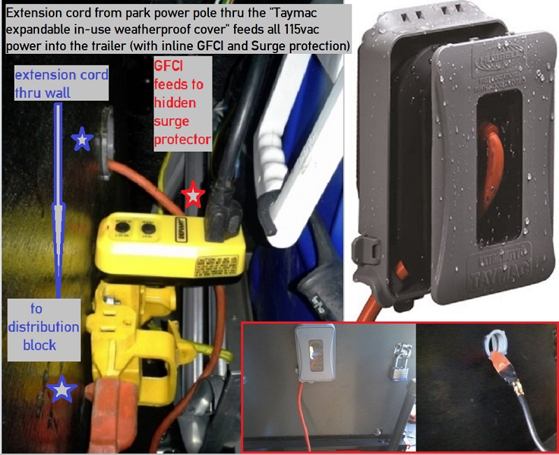

Then there's the 120vac side. Choice of power sources: onboard 2500 watt generator or park power. The generator slides out from the galley/storage area, so it can be operated without heat anf fumes in there. I've only used it a coupla times, and only where park power was unavailable. The 120v output cable is unnattached while park power is used. When at camp, I run a 25 or 50 ft extension cord to the park power pole, then feed it thru a Taymac in-use cover into the galley (on the streetside), whre it attaches to a 6-way distribution block,
power cord thru wall to distribution block.jpg (169.99 KiB) Viewed 1118 times

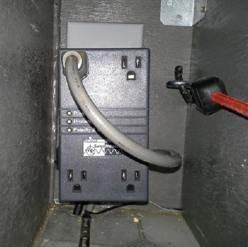

which feeds a GFCI (which supplies power to my outside lighting at camp), and to the resettable surge protector (which feeds power into the cabin, to another distribtion block).
surge protector installed.jpg (87.56 KiB) Viewed 1118 times
