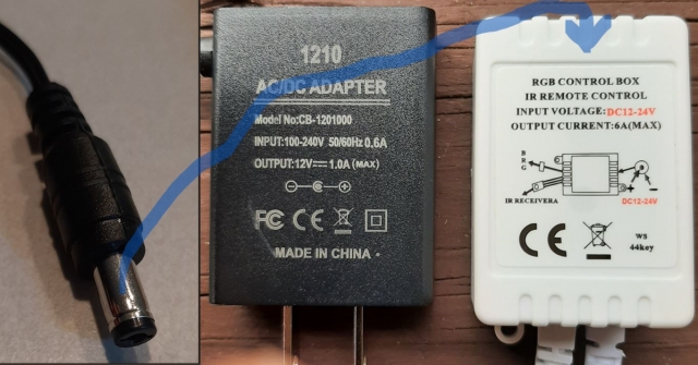

Recently purchased these 12V string lights: https://www.amazon.com/dp/B08B8BB51N?re ... tails&th=1
I was hoping that the lights would just come as 12v lights but they have the AC/DC adapter to use for powering them. Is there a connector I can use that I could wire these directly to my fuse block without having to plug them into AC? Would there happen to be a connector that has the end marked in blue in attached picture that I could use to hook directly to the DC terminal block? Thoughts or suggestions on how to safely do this are appreciated.

Cut off the connector and connect the wires to your terminal block. Pay attention to the polarity. Hooking up reversed may damage the controller.

Thank you for the reply; especially for the polarity part. :thumbsup:
