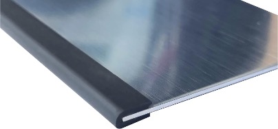

Depending on the gauge thickness of your aluminum sheet, maybe edge trim on each sheet would work.
https://www.amazon.com/Rubber-Channel-P ... =1-30&th=1
trim edge jpg.jpg (12.68 KiB) Viewed 1299 times
Or, maybe make your own by slitting some thin rubber tubing glued on with silicone caulking.

The aluminum I am using is from the .040 aluminum siding I cut out of my trailer side when installing the A/C. It was a perfect size piece, which I didn't expect. According to this website: https://www.riversidesheetmetal.net/she ... ght-chart/ it looks like it would be around an 18 gauge if I read it correctly. Edge trim sounds like a reasonable idea, thanks!

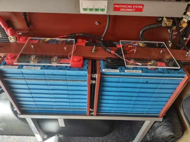

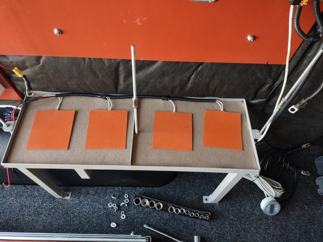

I used 1/4" aluminum plate under mine, my reasoning was that is would serve as a heat sink to keep hot spots from forming under the batteries. I doubt your 18 gauge plate will do much to spread the heat around and honestly I don't think my plate does much either. I doubt I would use one if I was to do it again. Here's a couple of photos to show you my arrangement, my padding is basically a piece of carpet:
You don't need any kapton tape on the plate if this is your battery; it's in a non-conductive case:
