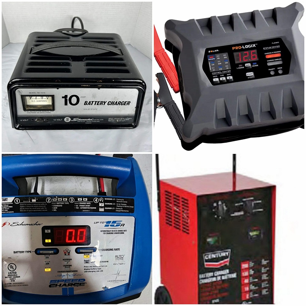

What kind of "plug-in charger" are you using? I use a 1.25A Battery Tender for my BMW X5, an Amazon Basics Battery Charger 2A for both my Chevy and GMC pickups, an Autozone Duralast 1.5A charger for my HHR Panel, a Battery Minder Plus 1A for my AGM battery in my trailer, and a Black & Decker Bm3B 2A charger as a backup (or for the riding mower, and formerly used on my wife's Cobalt, while it was being worked on for 3 years). All these use high-frequency pulsating power to desulphate and maintain batteries, and can be considered "smart", as they can be left in place for months at a time. Mine are plugged-in immediately at home, after I arrive there, and they keep my batteries charged full-time. They've also prolonged their lifespans, as the average lifetime for the Flooded Lead-Acid batteries has been 11 years, and the AGM trailer battery is now 13+ years (after two occasions where it had to be totally reconditioned, back-from-dead, before I started using the trickle chargers on everything...except my wife's daily driver, because she never remembers to unplug it). These charger-maintainers are good to keep a battery up to snuff, even to keep one from freezing in cold weather (Texas cold, that is), but will not resurrect a battery from the dead.

This procedure (with some variations, necessary for my equiments' limitations) worked twice for me, using a combo of two chargers: a Schumacher XCS15 ("smart/automatic" charger/maintainer, 2-6-15A), and a Century wheel charger (fully manual,10-40-150A), but it was a prolonged effort.
I just bought a Solar/Clore Pro-Logix PL-2320 ("intelligent" battery charger/maintainer with "power supply mode", 2-10-20A) which would make battery resurrection much easier, as the "power supply mode" will maintain your settings as well as a fully manual charger (but with the added feature of providing clean power). And, if the battery has fallen below 10v, the Schumacher needed to be fooled with a secondary 12v (provided by a spare battery) so it would turn on, but the Pro-Logix has a special start button that turns it on with no battery power needed. It will be what I use from now on, if ever I need to bring a battery back to life.
i used the two on bottom;new charger on top right, oldest (fully manual) unit on top left is a backup
But, as Squigie's post above stated, your battery may not respond to the strategy outlined here, but also, what do you have to lose just trying it? Good Luck!
