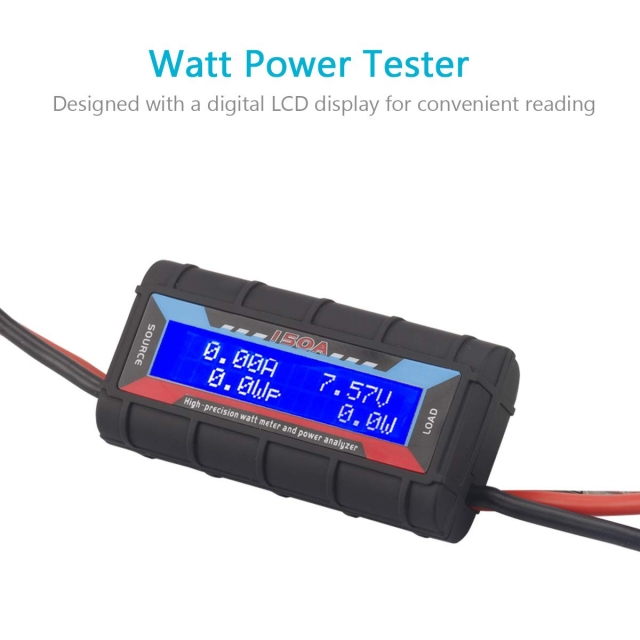

I have been looking at the Watt Power Tester and some of its equivalents as I do want to find what voltage is getting through to the dometic refrigerator. I really didn't see anything that appears capable of doing this and even if I was to get my multimeter probes in to the socket it likely would cause a short circuit. If there was a viable way of testing this I would certainly like to see how much current loss I am getting.
Tim: I believe what you were suggesting instead of the current getting to the cigarette lighter socket was to test the running current used with the refrigerator's operation. I am assuming that the only way to use the shown tester would be to split the dometic power cable in 2 and twist and solder the connections to allow this inline display to be read properly.
I know that this is something that is commonly done, but I don't know whether I would trust my wire connection skills to permanently stay in place. There always would be a weak point that if the fridge was pulled out of the camper without disconnecting it could break apart the wire connections. I don't know whether the benefit would out weigh the potential downside.
In reading refrigerator testing forums I have heard another option which is a "kill a watt" current tester. The only thing is, I don't know how this might be used with DC instead of AC power.

immped64 wrote:I have been looking at the Watt Power Tester and some of its equivalents as I do want to find what voltage is getting through to the dometic refrigerator. ...
Did you mean to say what amperage is getting to the fridge?
Not the only way, but, correct. If you install the ammeter inline at the fridge you will be able to monitor amps, watts and kilowatt hours. Simple math... to convert the kWh to aHr you divide the kWh reading on the ammeter by the voltage of the source, your battery's voltage. That will tell you the aHr's used. You should use 13.3, or thereabouts, for the voltage if you are using your new LiFePo4 battery. If using a SLA battery use 12.3 volts (or thereabouts).
I am going to go out on a limb and say that your wire termination skills will produce a better connection than any 12v cigarette lighter socket. On my first trip with my first TD the plug vibrated out of the socket repeatedly. To the point every time I stopped I had to plug it back in.
The Kill-a-watt I have is for 110 volts only. A 12 volt ammeter is going to do the same thing, sort of.

You could build your own cigarette lighter adapter if the need arises. Cut the extension cord (below) in half, wire the ends to the ammeter and away you go. The only other item is four blue butt splices.
https://www.amazon.com/LoveDeal-Precisi ... 6109ace758
And
https://www.amazon.com/Cigarette-Lighte ... 725&sr=8-6
