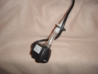

Well I had an idea so I thought I would give it a try.
I saw a 120V submersible fountain pump on sale at HF.
So I "invested" the $4.99 into it for a little experiment.
I have the JC Whitney hand pump faucet.
It works OK but it is a little hard to rinse your hands or dishes
and pump it at the same time.
So as an experiment I hooked up the fountain pump to the water line. I drop the pump into my water jug.
The pump is plugged into a switched outlet which is protected by a 15amp breaker and is also GFCI protected.
It produces a slow steady flow of water, no splash at all.

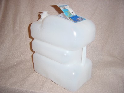

I bought the smallest pump they had. I thought it would fit into my 5 gallon water jug but it is too big.
So I bought a 2.5 gallon "disposible" jug from Krogers (which comes full of spring water) and cut a flap in the top.
Anyone looking for a cheap under the counter water jug?? This is a great option!
The nice thing about this is the hand pump faucet still works with the submersible pump attached.
So with or without power you still have a working faucet.
So my question is..... is this safe???? Will the GFCI protect you in the event of a short??
Keep in mind I did this as an experiment to see if it would work.
It works great but I don't want to use it if it is not safe!
The pump is 120V/0.09amps/60 Hz.

I'm no water or electrical expert (although I did stay at a Holiday Inn Express last night) If I read your post correctly its a submersible fountain pump (made to go in the water) I would say your fine. My aquarium has a similar pump and the fish and frog are all doing fine.

Boy, thats a tough call. Yes, its protected by GFCI but I've read that in the field, GFCI has about a 50% failure rate when tested in existing buildings (line transients take them out). I bet the plug on the pump only has 2 prongs so there's probably no ground. The motor is potted so the chances of it ever energizing the water is probably pretty slim. But, if it ever did, you'd be the only path to ground. I don't think I'd use it in my trailer. Why not look for a DC pump with about the same GPM and use that instead? Then you never have to worry if you sneak a drink out of the faucet when your wife's not looking (except that maybe she is looking). ;)

The pump is grounded.

Because a direct short will not trip a GFCI (you just become a resistive load) the only way a GFCI will work then is if some current leaks out of your toes to earth.
Points to note
Because it includes earth and a GFCI under all normal circumstances you will be safe, but you must bond the tap base and metal sink to earth.
If you use a genny or invertor to power post here because there are several important details you need to look into if you do intend to.
Is it rated as safe for fish ponds? I ask because fish are more sensitive to Plastics and resins, ie if its safe for fish its usually good for us too.
I cannot see it being dangerous, assuming good Earth Bonding, Good GFCI and the fact that the Pump is earthed too.

It looks ok to me, I only worked in the manhine Ind most of my life and I am retured now Oh Oh retired that is and all the machines I worked on used or had the setup to use water as coolent and most of the coolent pump that we used were of the type you hive there and I'm still hear to talk about it. Oh and I burned up more then one of those little pumps from to rich a mix of coolent.

The sink and faucet are not grounded yet but if I decide to use this setup I will ground them.

If you are powered by mains hook up (shore power, campground power post or whatever you call it) then all should go well.
However if you intend using an inverter to power then post here first there are some important differences on how these work with relation to earth and GFCI's
Same with Generator's they can be earthed differently.
If campground only dont worry

George, you are correct, you do become a resistive for a very short duration, about 3 milliamps for approximately 1/30 of a second. This is at the threshhold of sensing a shock well below any dangerous shock. Now, that is only if the darn thing is operating as advertised.

If none of that current leaks out through some part of your body to earth then the GFCI will never cut in and you will die. Hence the reason I go on about ensuring you have a good earth and that all possible conducters are bonded to the earth.
