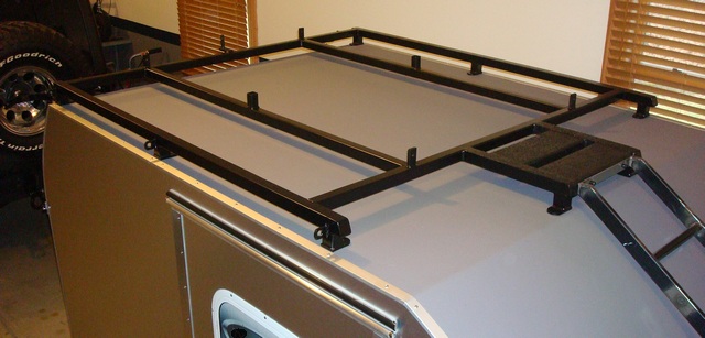

Postby Endo » Sun Apr 18, 2010 9:41 pm
Tears4mama it is not actually a rooftop tent.
It's my "budget" version of a rooftop tent :)
It is a tent cot.
I took the legs off the tent cot.
I welded up a roof rack and secured it to the custom rack.
The tent cot came with a cover that I also modified to fit with the rack.
An actual rooftop tent is VERY expensive ($1000-2000).
I bought the tent cot on Amazon for $250.
The rack bolts to the roof along the edge of the teardrop and at the front. The walls take most of the load.
The top edge of the wall I framed in 1x3 oak. The rack is bolted through solid wood blocking as well.
The front edge of the roof was framed with three 1x2's glued together.
The roof rack took some fabrication and welding but I love that stuff. It was fun to build.
I also have 2 awnings that mount to the roof rack but I don't have any pictures of the awnings yet.

Postby Endo » Tue Apr 20, 2010 7:00 am
Hi Duke,
Thanks for the compliment. I never started a build journal for this camper. Maybe I still should even if it is nearly complete.
The sides are brushed aluminum.
The top/front/rear is covered with marine vinyl flooring. A product called Nautolex Decko Dot.
http://www.yourautotrim.com/nadedotfl.html
Designed for outdoor use, Nautolex Decko Dot Marine Flooring can be used on boat decks, floors, patios, walkways, etc..
Decko Dot is manufactured with a non-slip "Raised Dots" surface, ensuring a great grip for any surface. Designed for a "glue down" installations.
Marine Flooring is manufactured to resist U.V. Rays, Mildew, Salt Water, and other harsh outdoor elements
I knew my roof would see some "foot traffic" so I liked the non-slip surface.
I am pleased with it so far.
It handled the 3000 mile trip without a problem at 65-70 MPH.
Brad (aka Endo)

Postby Endo » Tue Apr 27, 2010 6:47 am
I looked at the specs for the Nautex material, and I like what I see, so I think tentatively I'll plan on putting it at least where you did, front, back and top. But you've actually installed it and camped with it, so let me ask you: would it be practical to put it on the sides, as well? It eliminates a lot of finishing work, but would it get cut up too much during use?
TheDuke
I suppose you could use the Nautolex on the side walls as well? It will definitely give the teardrop a very different look!
The "look" is not for everyone. Far from traditional.
It didn't really eliminate any finish work. At least not the way I did it.
I did my best to weather proof this one!
The camper was sealed with epoxy, and then primed with paint.
The Nautolex is one continuous sheet from front to back.
The Nautolex was glued in place with vinyl adhesive.
The Aluminum was also attached with adhesive to the side wall.
The corner trim was formed and test fit. I pre-drilled each screw hole.
The trim was removed.
Sealant was placed under the trim.
Sealant was place in each screw hole.
I don't think there is much more I could do????
One BIG plus is I can store this camper in my garage.
I feel storing it indoors is a huge factor in the extending the life the camper.
Brad (aka Endo)
