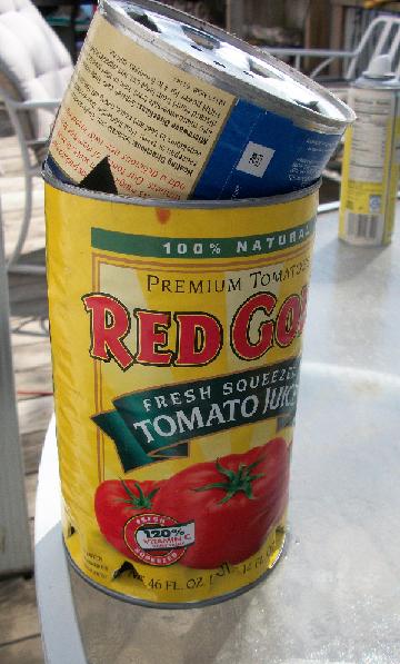

Postby bobhenry » Mon Apr 11, 2011 1:23 pm
bobhenry wrote:For a couple of years I used a tomatoe juice can with a smaller can dropped inside to raise the coal bed. I think the little squatty can was a beef stew can but I know a la choy chow mein can fits nice.
Got out a can piercer and went crazy around the bottom side of the juice can then pierced holes around the bottom side and the top outer edge of the little squatty can.
I simply dropped the paper in first and loaded the charcoal and lit a small tail of the paper it made a great little chimney !

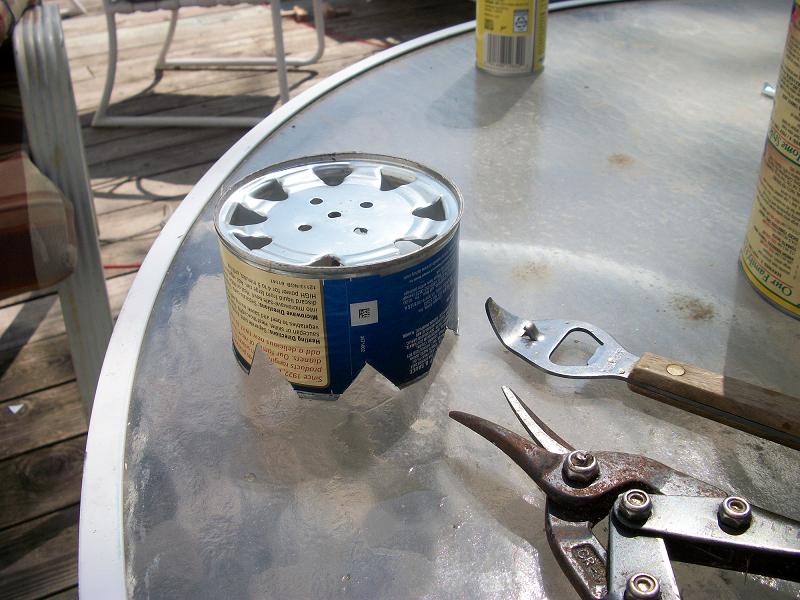

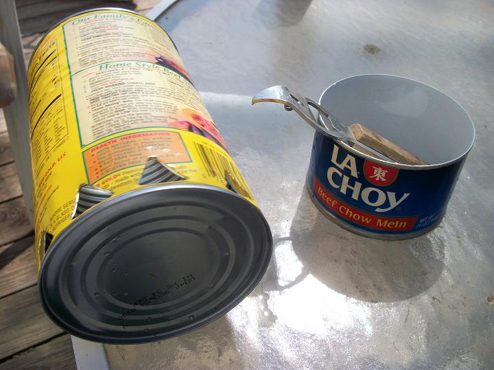

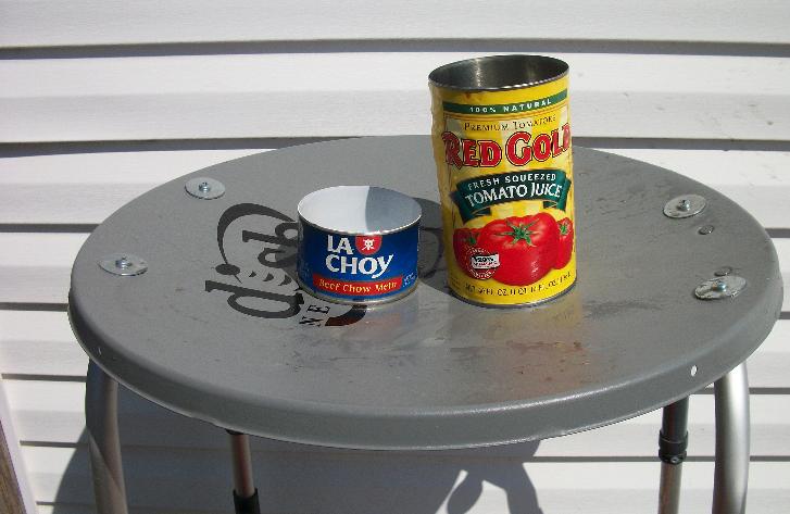

UPDATE WITH PICS
takes about 4 minutes start to finish to make one. All you need is a can opener , a can piercer , and a pair if tin snips.
To start your charcoal just drop in the paper then the little can as a stand off then your briquetts. This one holds eighteen :(
Now just light the paper thru a hole at the bottom of the tomato juice can and stand by.

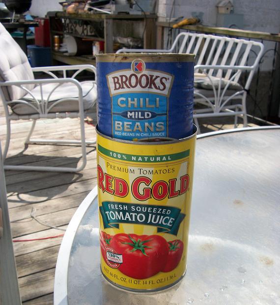

I found the brooks chili bean can also fits. I got clever and cut top and bottom out of the this one and used it as an extention to the top to add additional briquetts to the now taller chimney.

Postby dratkinson » Fri Jul 29, 2011 5:03 pm
UPDATE WITH PICS
Your's sounds like a good idea to save some money by not needing to buy a chimney charcoal starter.
I understand the larger can's air holes (and solid bottom) are on the bottom for air vents.
But after that, I become confused.
My confusion is:
Charcoal.
Do you put the charcoal in the little can on top, or is it placed on top of the paper in the bottom can?
From raise the coal bed I think you are putting the charcoal in the little can on top.
From your picture (above), the top can's open bottom is downward, so I think the charcoal is placed on top of the paper.
Top can.
Is the little can on top used to create a chimney, or does it hold the charcoal?
Is the little can's closed end (with holes) on top or on the bottom?
Sorry to be so dense.
