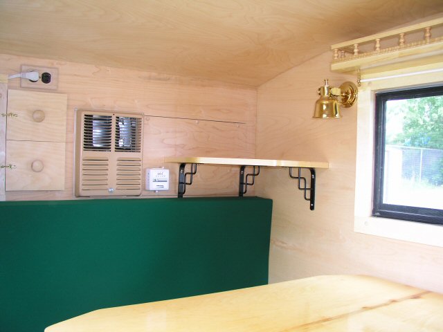

Postby mikeschn » Thu Nov 23, 2006 8:05 am
Even new, the forced air furnaces are not THAT expensive...
Here's how we put it in the Lil Diner...
and here's how I put it in the Baja Benroy
pic here
and don't forget Q's arrangement...
pic here
Postby halfdome, Danny » Thu Nov 23, 2006 12:33 pm

Mike do you have an exterior shot of that heater? Danny

Postby mikeschn » Sat Nov 25, 2006 6:03 am
Danny,
Does this help?
