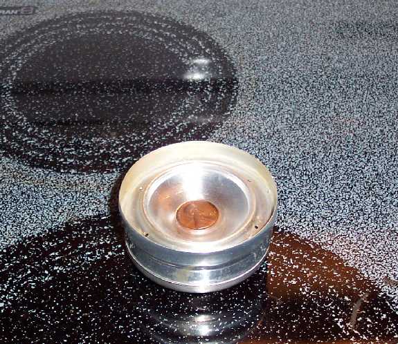

While visiting family in Southern Oregon this past weekend, I got to talking about our teardrop and camping. My Uncle, an avid camper/hunter, showed me a Penny Stove that he made. It's a neat little item!
Here are the instructions:
http://www.csun.edu/~mjurey/stoveinstruct.html

Yes, I've made several different types. They work very well to boil 16 oz of water in 5-6 minutes. That's about as long as they will burn on the amount of fuel they hold (2-3 Tbs denatured alcohol). They are quite effective to heat water for tea, coffee, soup or dehydrated (freeze dried) meals.
Also known as Pepsi can stoves as well as other names. Google for other designs.
They seem so harmless just sitting there burning with an almost invisible flame that they become quite dangerous. Don't let your guard down when using them. :o

Note above post -- I've made several. They are truly neat for the niche they fit. Work like a charm burn hot and fast and then poof -- it's gone in about 5-6 minutes but will boil a 16 oz of water in that time.

made 'em and taught Webelos Scouts to make 'em, altho we didn't use Heineken cans :D
you can make a penny stove or a "photon" stove with several varieties of cans. The one out of two "Fancy Feast" cat food cans used to be my favorite. I rather prefer the ones made from green chili cans these days (cat food cans are so thin now they melt).

Looks similar to stoves I've made for backpacking. I've made several from Foster"s Lager cans, and they weigh only about 2 ounces. They burn denatured alcohol, and besides, it gives me an excuse to empty the cans. LOL Details are on the net, just google homemade camping stoves. They are very simple to make. A large can cut down and with vent holes makes a support for your pots.

I had no idea such an invention even existed. It didn’t take long to figure out that not only does it exist, but there are a dozen (probably more) variations of the silly thing.
Well, I got sucked in… I built one, then another, then another. Now I’m going to try a different design. It’s like some kind of weird sub-culture. It lures you with many possibilities, and then makes you build something. Sound familiar?

This stove is designed to burn only denatured alcohol or absolute ethanol. It would be explosively dangerous to use gasoline, white gas, camp fuel, kerosene, or any other fuel in this stove. Isopropyl alcohol (rubbing alcohol) will not work either.
The flames from these fuels are practically invisible and if the fuel is spilled near the flames, this can result in a fire catching and spreading very quickly. Handle with care and be sure to have no flammable material around the area of the stove. Do not use a stove such as this near peat sites or tinder-dry vegetation.
Ask for help from an adult, teacher or parent with cutting the cans if you are a kid or if you do not feel confident in cutting it yourself. Take care not to slip with the knife or scissors while cutting.
The cut edges of the cans can be sharp. Use caution when working with them.
If you have too many large holes in the top, the fuel will not burn cleanly.
Do not keep your hand too close to the heat or flame when lighting. If the stove becomes too hot while you are lighting it, take a rest until it cools down enough.
Be careful not to burn yourself.
Be careful with sharp objects used to make the burner holes.
We use one that uses one burner folds for a back pack and uses fuel cans from a chaffing dish we just put the top back on to put out the fire..
