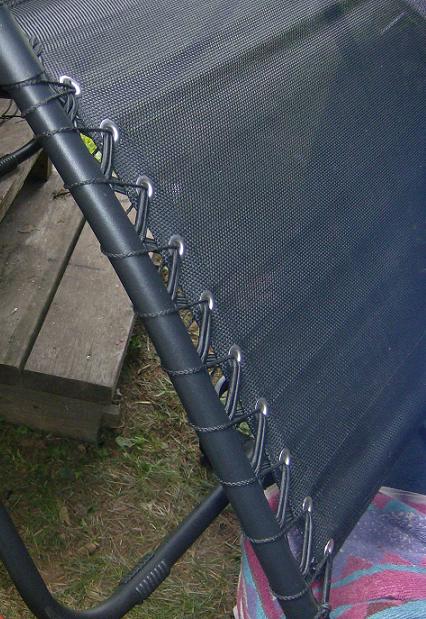

I was given a very nice camping folding gravity chair for my birthday.
It's built for big guys with wider seat and 300 pound rating. I really like it but decided it would be best to offer it a bit of help. I have seen a few fail when the cording from the frame to the eyelets broke, so here is my answer for those that might be interested !

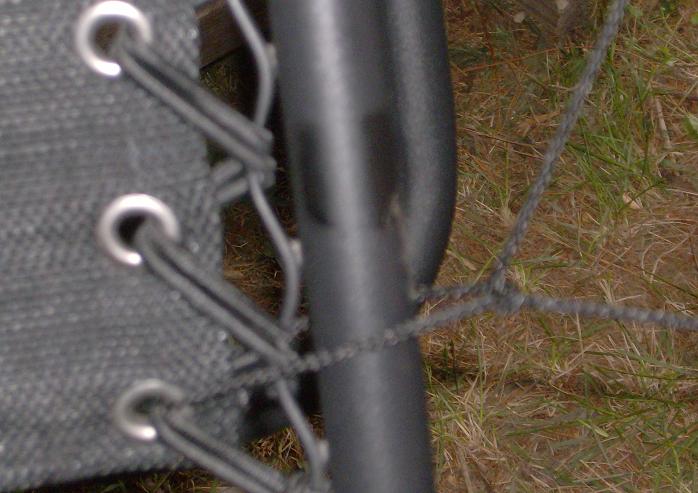

I purchased some black nylon cording at a fabric shop....
Tied it off at the frame....

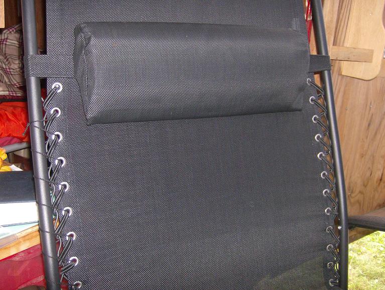

then whipped it thru eyelet and back around the outer frame then the next ......
I just noticed I missed the last eyelet :x
Now that I have "backup" I feel much better hope it helps the chair to last a bit longer cause as I said I really like it !

I was in a bit of a pinch when mine started to fail from lots of use. (mostly afternoon naps) So I just used Zip ties I had in the truck but I'll probably re-do it much the way you have.
One thing I wonder is if it might be a good idea to leave some slack in the cord... It seems to be best if the bungees and the new cord could share the weight evenly. Either way, I love the chair! Nice work! :thumbsup:
