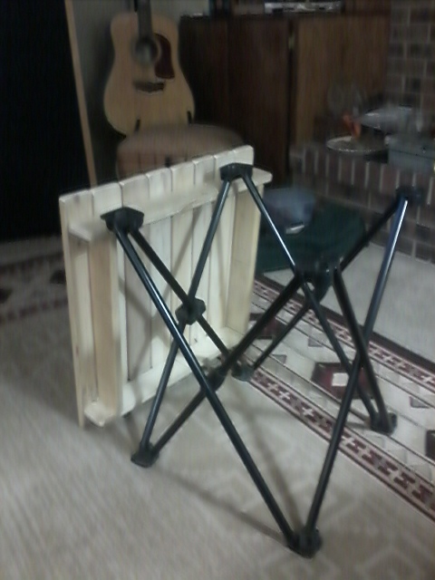

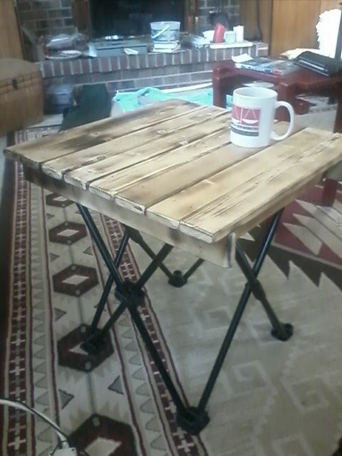

Every time my kids went to a soccer game I saw those cheap bag chairs in the trash. What a waste of a good folding mechanism I thought. I've been wishing for a small folding table for camping so I finally made a table top to fit a folding bag chair frame. The pictures should give enough info to build if you like the idea.

Actually, a shower mat/floor is a good double purpose. Just the right size.
Another cool shower mat idea is to use two lengths of nylon webbing screwed to the back of cut to lenght 1x boards. The mat can be rolled up when not used and just unrolled quickly when the shower is set up. I suggest 1/2" no.8 screws with finish washers through the nylon webbing to attach to board. I'm thinking this type of mat would make a nice floor for the 3x4 foot changing area under my hatch. A kind of wooden carpet.

Hey, that's a slick idea!
What about using some of that fancy recycled plastic lumber for the top? No more worries about what got spilled on the camping table.
