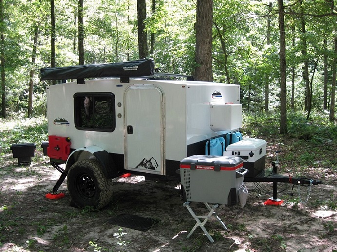

I have like the Engel line of portable 12v.\110 fridge freezers. I have their MR 040 Eclipes model. AC/DC compatible, will operate up to 30° off level, 12v power consumption 0.7- 2.7 amps per hour. Engel portable fridges been around for more than 50 years. They are pricy, but they will be the last portable fridge you'll buy, a fridge for life.
https://www.youtube.com/watch?v=xJXfNblDMmw
