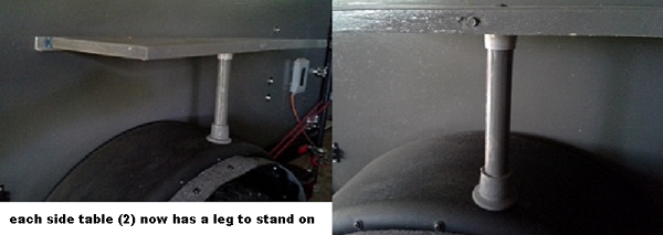

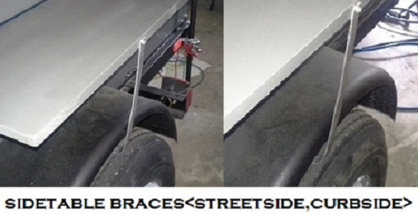

  • After seeing the Oregon Trailer side table workmanship, and that of others on the site, lately, I felt that my two side tables didn't "have a leg to stand on"...literally. I was using two pieces of flat aluminum stock, with a locator pin to steady them, but they were cheap looking and too spindly to really steady the side tables.
    old flimsy table braces.png (362.3 KiB) Viewed 8547 times
    just a poor excuse for side table support
  • So, I decided that an improvement was required. I made a solid leg for each to stand on. I took two of the lower legs off of an old shower seat. cut them to the length I needed to hold each table firmly above the fenders, and used a 3/8" carriage bolt with washers/nuts sized to fit into the leg, and hold it steady, without wobble, when under the table, and slid into place on the fender top. I also painted them to match the grey walls.
    side table leg photo.png (182.68 KiB) Viewed 8547 times
    much steadier, and better appearing supports
173193172890148599
