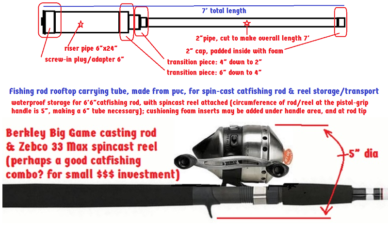

  • Well, as is my usual custom, of making stuff for my TTT and camping trips that are few-and-far-between http://www.tnttt.com/viewtopic.php?f=2&t=70367&hilit=usual, I'm going to construct a custom rod & reel transport tube, to mount on the roof of my TTT (I love modifying my TTT), and which I can detach if I need to safely transport my rod & reel via my HHR or truck. I've broken several rod tips in the past, and even damaged the reels, in the days before I started buying pickups (2 with shells added, later) to haul gear (fishing, camping, hunting, baseball, softball...all long ago). Since I've already exceeded my weekly spending limit (wife-imposed), I'll have to build my storage tube next week, if I can. I've already sourced the parts (some nearby at HD, some online, and a 2" pvc tube I have leftover from my last home project. I have already made a scale? drawing, and just need the parts to build it. Mounting system will be figured-out later, though, but I already have the attachment points for the 7' tube marked. I sure miss the construction phase, and like small projects like this.
    rod tube drawing.png (298.25 KiB) Viewed 6091 times

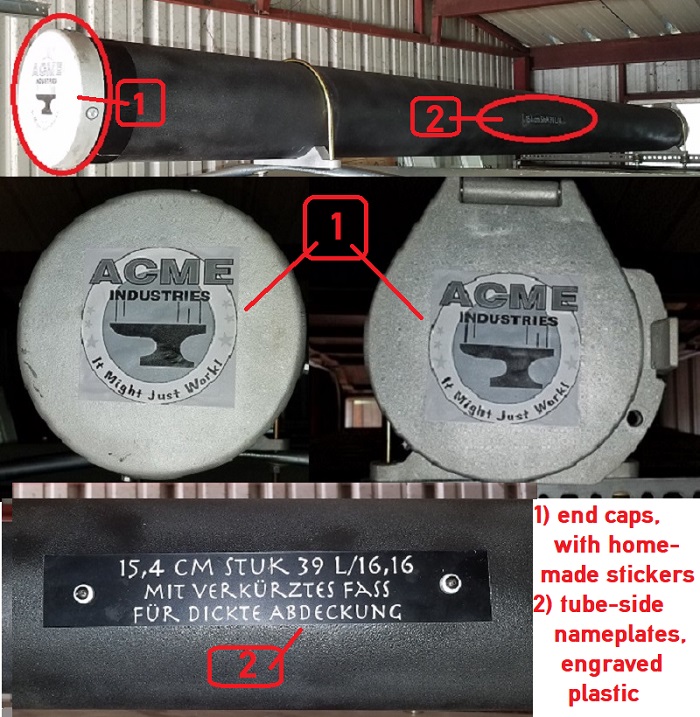

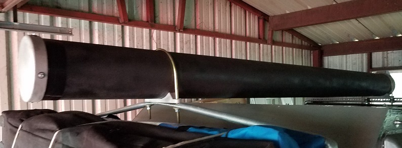

  • To close out this thread, I did finish my fishing gear storage project, which is more fully outlined in another thread. http://www.tnttt.com/viewtopic.php?f=2&t=70367.
  • The storage tube ended up 98" long, and sits on two supports, over the center roofline, accessible from the rear. I spent much more than I wanted to, but once I get an idea in my head, I usually go to any length to make it happen. I figure that I spent around $175 for everything used to construct and mount the tube (with adhesives, screws, and some paint leftover for other projects, included), and 15 hours of my time (no cost there...I'm retired) in assembly and installation. And probably 30 hours on my labels, and another $25.

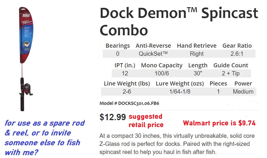

  • Once again, I went overboard, having imagined the project to be inexpensive and easy, but it ended-up not-so. In my defense, after completed it, I now can safely store my 6'6" catfishing combo rod & reel, my 6+' hiking staff I made years ago, and a 30" Dock Demon rod & reel combo (bought for $10, as a spare) inside the tube, and not just thrown into my truck bed. At 8'2" long, it can probably hold other supplies, after the rods/reels have been inserted (18"long x 6"diameter space available).
  • The tube should clear the garage door with 1.5" to spare, if my latest measurements are correct (I've measured three times), but haven't yet tried to pull the trailer from the garage. My vision isn't what it used to be, so I need a second set of eyes to observe the tube as I pull the trailer out, to make sure there is no contact made. My wife is never home anymore, or is busy in her home office, or something else, so I haven't asked her to come look, yet. Maybe tomorrow, if it doesn't rain?
    lockable storage, out of the way, on top of the trailer!
    conduit carrier to be used for fishing gear.jpg (87.88 KiB) Viewed 5660 times
    adding my "personalization" to the tube
    tube-labelling complete.jpg (211.39 KiB) Viewed 5660 times
    inexpensive rod & reel combo, bought as a spare
    Dock Demon combo for backup.jpg (138.12 KiB) Viewed 5660 times
