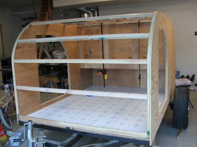

I did mine this way too. In this picture the inner skin is not on yet. It was cut flush with the bottom of the 1"X 3". The 1"X3" sits on top of the floor to support the weight. The wood bellow the 1"X3" covers the frame.
Also, all the screws were removed before the inner skin was installed. They were just used to hold the wood until the glue dried.

bledsoe3 wrote:Also, all the screws were removed before the inner skin was installed. They were just used to hold the wood until the glue dried.
Which glue? Seems like you have a lot of faith in the glue :D

Postby bledsoe3 » Mon Jul 16, 2007 8:42 am
I used Titebond II. Plus I placed a spar right on the deck in the front which is screwed through the wall and the bulkhead sits on the deck too. It's screwed through the walls also.
