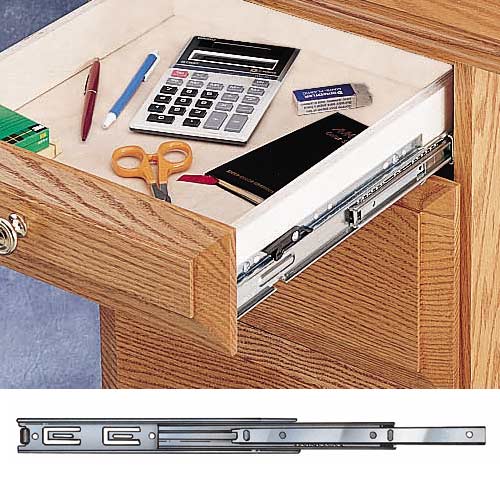

OK, I don't think that you can buy a bottom support that size, but you could make one. Just use a full length piece of hardwood under the drawer that is shaped with an 'outside' dovetail and then put the 'inside dovetail on the very back, bottom of the drawer. You should be able to get almost full extension then.
Your could also, make the sides out of hardwood and then put a tab that hangs down on the very back, bottom of the drawer. This would allow your to pull the drawer all the way out and even tip it down if you wanted when it was all the way out.

Postby toypusher » Fri Oct 14, 2005 4:19 pm
Just checked my latest Rockler Catalog and look what I found:
rockler # 97809
Accuride series 2632 Slides 8'' length - Zinc
Quantity Discounts Available:
10 or more: $21.59
In
Stock $23.99
Pair

Postby mikeschn » Fri Oct 14, 2005 4:47 pm
Kerry,
Your the man! Rockwell drawer glides it is... I'll start modeling it up this weekend... Look for something when you come back from your fathers birthday party middle of next week! ;) :D
