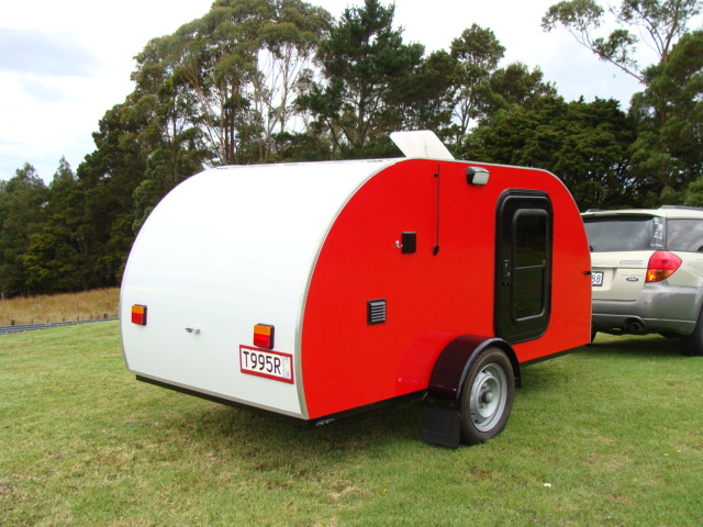

If your frame looks good why not show it? :D
We had originally planned to run the alloy trim along the bottom edge of the side walls to match around the top. This was not to hide the frame, but just to finish the bottom edge of the walls. But when we stood back and looked at it with the red walls and the contrast of the black frame it gave such a clean break between the two that we left the alloy off.
