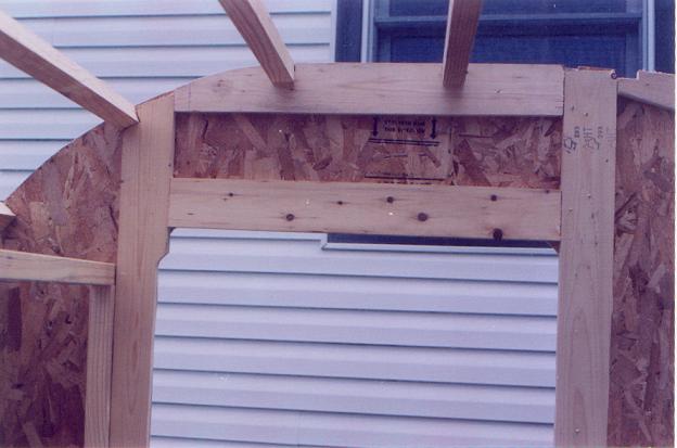

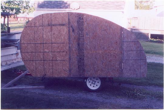

My build required 3 sheets of 1/2 osb per side, They were butt joined and cleated internally by screwing them to a 1x4. This created a 3/4 inch void in the wall for 3/4 blue foam insulation. I then skinned the inside with 1/4 luan over the 1x4 's and the foam. I used the same luan outside glued to the osb. My floor had 1 1/2 inch wheel well humps that had to go! So I put down 2 layers of 3/4 foam board and a 7/16 layer of osb over the foam. Galley wall has 3/4 foam under the luan also. My only short fall was my lexan roof. In summer sun you have a greenhouse and in extreme cold it will frost over to the point it will snow inside. We have camped at -1 and a -15 windchill and 95+ direct summer sun and neither were pleasant but tolerable. I have learned to cover the see thur roof with a reflective blanket in high heat and a heavy quilt in extreme cold and both methods help a great deal. I am sure this same technique would help any solid top tear as well.
Might not look real pretty but if it creates a good nights sleep who really cares. Yes I feel insulation is important if you intend to use your tiny trailer in extreme weather. If you are a 55 to79 degree weather camper then OH WELL !
