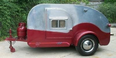

I'm hoping between Andrew and I we can come up with some CAD models and drawings for you... I notice that Andrew doesn't have the Kenskill on his page...
What do the rest of you guys think? The Cub/Modernistic or the Kenskill?
or maybe the Mechanic Illustrated Trailer for two... not necessairly in wood...
or the Benroy...

Although I am building a Cub/Mod profile (I like the looks best) it probably wouldn't be the best for a first timer (like me?) because of the tight radius in the rear. I think the Kenskill would be a good compromise. It has the same classic look but without the tight radius.

Obviously I prefer the Cub/Modernistic profile as that's the one that got me interested in teardrops, but I do agree with those who say the radiuses onto the bottom are a difficulty. However I think it's these two curves that make this profile so appealing. I think there's a compromise there somewhere - a bit more curve than is showing on Steve's stripper, but not a lot.

angib wrote:Obviously I prefer the Cub/Modernistic profile as that's the one that got me interested in teardrops, but I do agree with those who say the radiuses onto the bottom are a difficulty. However I think it's these two curves that make this profile so appealing. I think there's a compromise there somewhere - a bit more curve than is showing on Steve's stripper, but not a lot.
Andrew
Andrew,
Which profile would look best with both a round fender like Steve has, or a 40's style fender?
