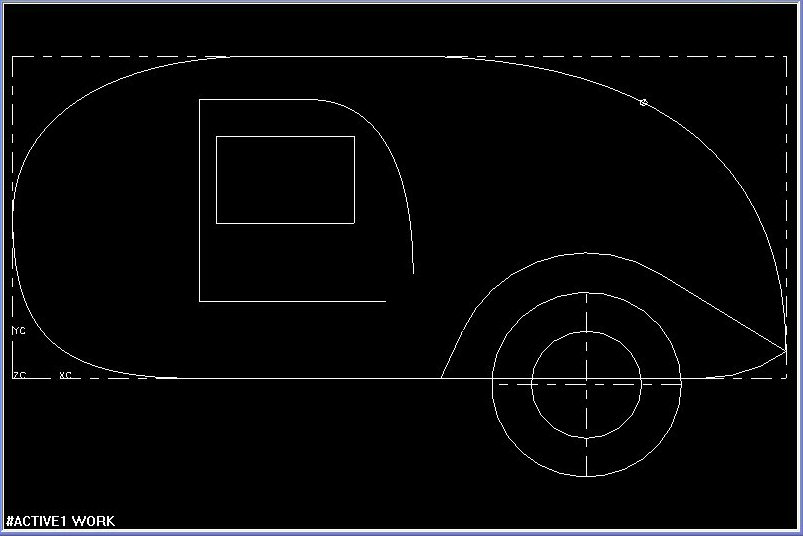

Postby mikeschn » Wed Apr 13, 2005 6:26 am
Here's a rough outline of what I am thinking so far... Did I miss anything important?

Postby mikeschn » Wed Apr 13, 2005 7:30 pm
Here's the profile for the Kenskill. (Thanks Andrew)
So what does a beginner put on the tongue? A battery? A storage chest? What would you want?
Postby Steve Frederick » Wed Apr 13, 2005 7:37 pm
I liked putting the battery on the tongue. It's easy to get to for wiring, no tricky venting..just simpler, for a first build.
Blessings, Steve

Front Box for battery and Propane bottle
Postby OkieSailor » Wed Apr 13, 2005 10:48 pm
A front mounted aluminum covered box with a dome lid to hold a propane bottle and a large marine stye battery. Maybe a Solar charger built into the box lid?

Postby Syekick » Thu Apr 14, 2005 5:46 am
The list looks fine Mike.
I like the idea of something on the front. Storage is good. At least a box. I like the exterior box idea that the Camp-Inn people have done. That was very creative of them. Extra storage in and out without the $$$ for the metal storage chest.

Postby GregJ » Tue Apr 19, 2005 5:36 pm
Mike,
I may never build one of these, but they are really interesting. I think if you put a plan into public domain you will find all sorts of variations in short order. That’s a good thing.
I could see a welded frame in both 4’ and 5’ right out of the shoot as well as insulated walls. What would you think of a modular approach?
I also liked the Cub/Mod lines but this looks easier to build and probably more functional.

Postby mikeschn » Sat Apr 30, 2005 1:01 pm
I think an easy variation on the Generic Benroy would be the Generic Cub/Modernistic. The only difference would be a different side profile and a larger piece of wood... 4x10 to start with. The profile could easily be matched to fit on an 8' long trailer.
