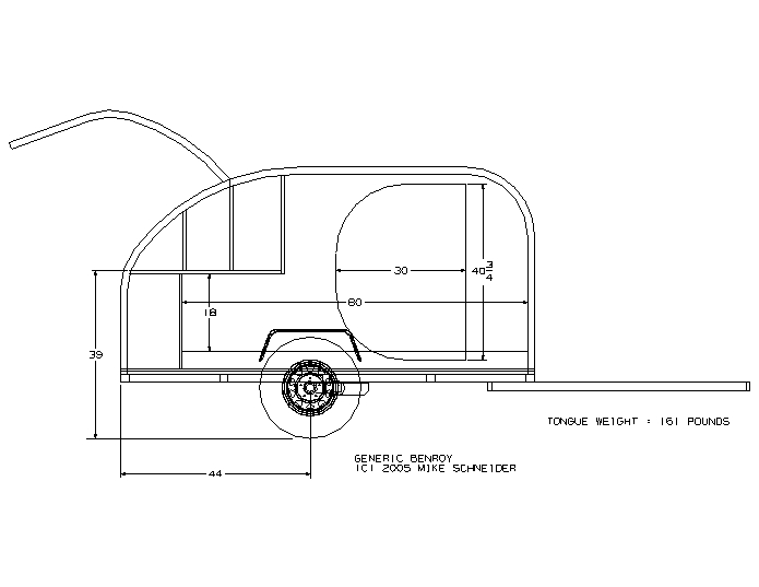

Postby mikeschn » Fri Apr 29, 2005 5:55 am
I am not going to be able to package as much into the Generic Benroy as I thought.
Here's my first pass at the design...
There's no room for a furnace or an air conditioner. :(
But on the bright side, there's a queen sized mattress in there... :o
Any thoughts on this design?
Postby toypusher » Fri Apr 29, 2005 6:18 am
Mike,
Looks good to me. See image for questions

Postby mikeschn » Fri Apr 29, 2005 6:48 am
The Generic Benroy won't have the front cabinet... it's too easy to hit your head on it.
Good question on the hatch though... Here's where it opens...
Incidently, the hatch will require a 5x5 sheet of baltic birch to cover it.

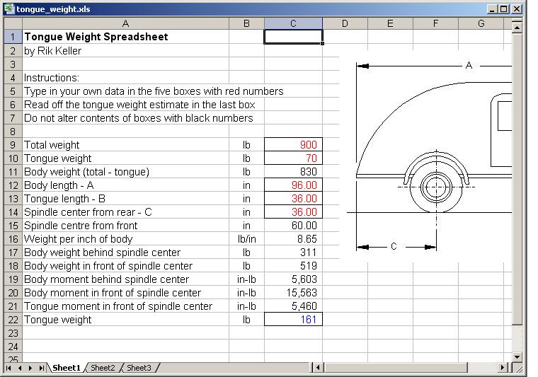

Postby Arne » Fri Apr 29, 2005 7:01 am
Please tell me the tongue weight is not 161 pounds.... should be 10-15% of trailer weight...
www.freewebs.com/aero-1
Arne
Mr. Subject Line
Posts: 5383
Images: 96
Location: Middletown, CT

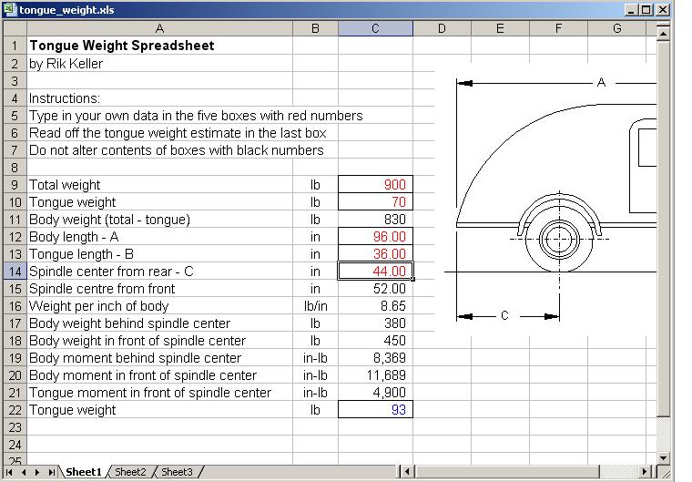

Postby mikeschn » Fri Apr 29, 2005 7:13 am
Arne,
Here's the spreadsheet...
In order to get the tongue weight down to 10% of the trailer I would have to position the center of the wheels 44" from the rear of the trailer. That puts the wheel right smack into the doorway.
Postby mikeschn » Fri Apr 29, 2005 7:20 am
Of course, I could always play games with the door, but then it doesn't look real comfortable for sitting in the doorway, or for pulling your feet up past the door...
