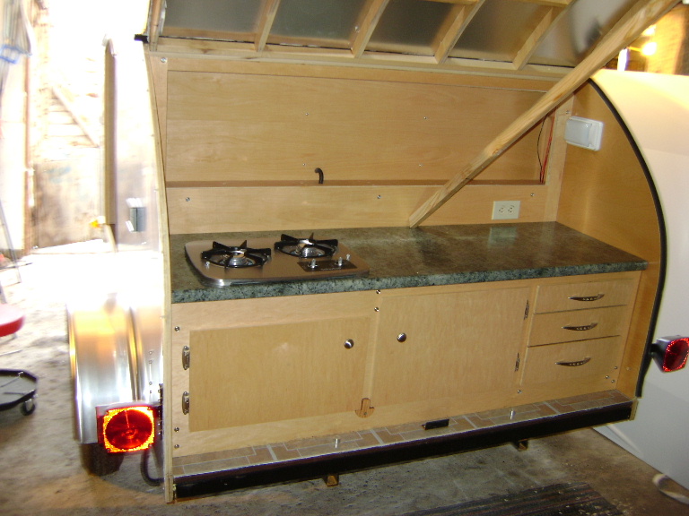

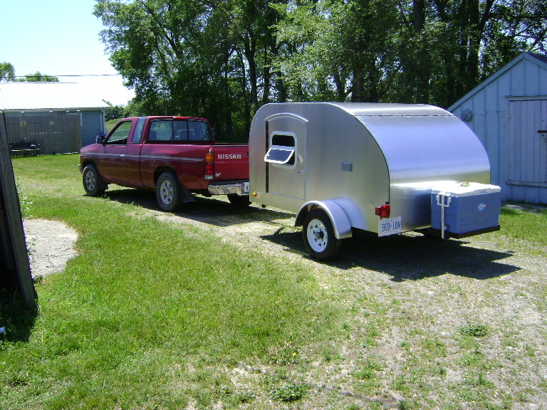

Here's my Benroy. A few minor changes from Mike’s plans, but nothing major. I changed the door shape, and use a welded frame. I have a 2 burner propane stove and a 5 lb tank on the tongue. I have a removable cooler mount on the back. I'm using a real memory foam queen mattress. I also made my own retro marker lights out of 1/2" aluminum plate, and powdercoated them. Weight: 880 lbs, 105 lb tongue with the cooler empty, 900 lbs, 98 lb tongue with 20 lbs in the cooler. Again, thanks Mike for all of the help on this.
I've posted photos on my gallery. Sorry, but I don't know how to link to them.
