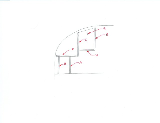

The first step is to assemble the main portion of the cabinet, as shown in this picture…

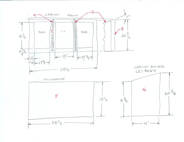

Postby mikeschn » Sat Aug 13, 2005 8:12 pm
Okay, I sketched out the drawings, and how they are assembled.
You'll notice the middle opening is for a combo DVD/TV, it doesn't require a door. The 2 outside openings are for storage and require a door.
All three openings in the galley require a door.
Here's the PDF file of these 3 drawings in full size so you can print it out...
http://www.mikenchell.com/images/cabinetdrawings.pdf
Let me know if you have any questions...

Postby mikeschn » Sun Aug 14, 2005 6:24 am
I had to update the drawings... the TV DVD combo is 11" wide. So I added an inch on each side..., and made the doors an inch smaller. The drawings in the previous msg are now up to date...

Postby mikeschn » Thu Oct 13, 2005 4:47 pm
I just put the cabinet drawings up for your review...
Other than the section view of one of the face frames, I think most everything else is readable... I'll be coming up with another picture of that section.
Please let me know if something else is not clear!
Thanks...

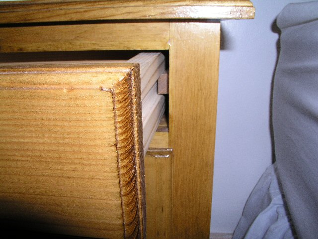

Postby toypusher » Fri Oct 14, 2005 3:34 pm
How about this?
toypusher
Posts: 43040
Images: 324
Location: York, PA Area
Postby mikeschn » Fri Oct 14, 2005 3:59 pm
Like this Kerry?
I don't like this for 2 reasons...
1) There is no positive stop. You can pull the drawer out and spill all the contents on the muddy ground.
2) You can't pull it out very far at all... For a 9 3/4" drawer I'm guessing you can only pull it out about 6". That makes it kinda hard to get stuff out of there...
Any other suggestions? Or did someone find a 9" full extension drawer glide?
