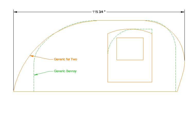

Here is an alternative profile for the generic trailer - it's loosely modelled on the original 'Trailer for Two' profile, so it's called the 'Generic for Two'.
The Generic Benroy profile is dotted in green for comparison.
The 'Generic for Two' is a bit less box-like than the Generic Benroy, has a body about 9 1/2 feet long, but doesn't have a huge amount more space, though the base of the galley is quite a bit deeper.
It's really an appearance thing - pick whichever you like to look of.
The extra length in the body does not mean that 4x10ft sheets of ply are needed - a simple butt-strap joint in the sides is perfectly acceptable.

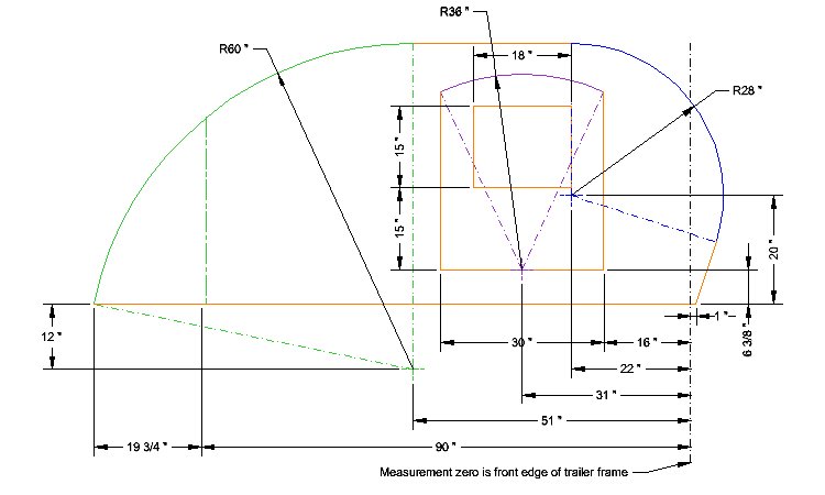

Here is the external geometry of the 'Generic for Two':
As you can see, the shape is made up of just two arcs and some straight lines. The centre of the rear arc is off the bottom of the sheet of ply, so a temporary extension will need to be nailed on.
Because the front is rounded, it can become a problem to define where 'the front' is, so instead a measurement datum is used - all longitudinal measurements start from zero at the front face of the trailer frame.
Andrew

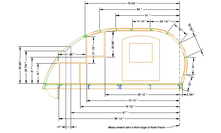

Postby angib » Fri May 27, 2005 11:43 am
And here is the internal layout of the 'Generic for Two' showing cabinet positions, spar locations, etc:
The cabinet locations are virtually identical to those in the 'Generic Benroy', except the base of the galley is deeper.
To stop your shins from getting bashed on the bit of floor sticking out behind the galley cupboards, the bit of floor is hinged at the back of the cupboards and folds down when camping.
The flap can be held up with a couple of door bolts but a pair of lugs on the hatch frames also pass under the flap when the hatch is lowered, locking the floor up.
