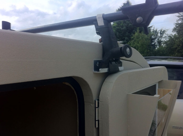

This is what I did using Yakima racks. The brackets were cut from 1/8" aluminum square tubing bolted through the sides. Solid wood carries the weight down to the chassis. This is on a foamy camper. On typical wood sandwich construction just make sure you have a continuous path of solid wood down to your floor or chassis. The most I've had on them is four kayaks (at 70 MPH) and it was fine. No sign of movement of the brackets.

Pmullen503 wrote:This is what I did using Yakima racks. The brackets were cut from 1/8" aluminum square tubing bolted through the sides. Solid wood carries the weight down to the chassis. This is on a foamy camper. On typical wood sandwich construction just make sure you have a continuous path of solid wood down to your floor or chassis. The most I've had on them is four kayaks (at 70 MPH) and it was fine. No sign of movement of the brackets.
Great idea! Thanks for sharing~! :applause:
