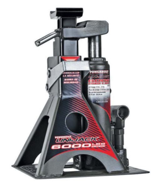

* Let's see???? I have several ways to jack-up my trailer, if I ever need to change a tire:
  • 1) a 5000 lb scissor jack permanently mounted under the tongue (or the detachable jockey-wheeled 2000 lb jack there, too) can lift the front end after I drop the two pipe-clamp rear stabilizers to the ground (capable of holding 1200 lbs),
  • 2) using either my old Chevelle's bumper jack (2000 lbs capacity) anywhere on the trailer frame, and/or my Hi-Lift jack (tested to lift 7000 lbs), also anywhere on the frame, 3) a portable 2000 lb trolley jack I also keep in my truck's crossover box with the bumper jack, or with my two Powerbuilt 3-ton Uni-jacks (which I also carry on trips, to lift my heavy pickup as well) under the axle.

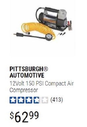

* EDIT I also carry a small air compressor, which has filled many a tire at dragstrips in the past, I hope I'll not have to use it either.
That same compressor is sitting in my tongue box.
