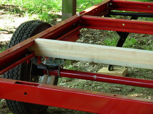

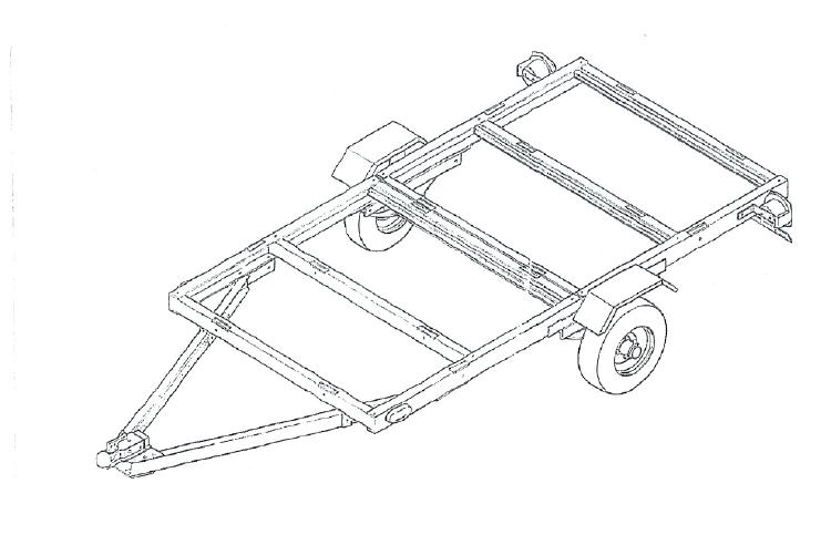

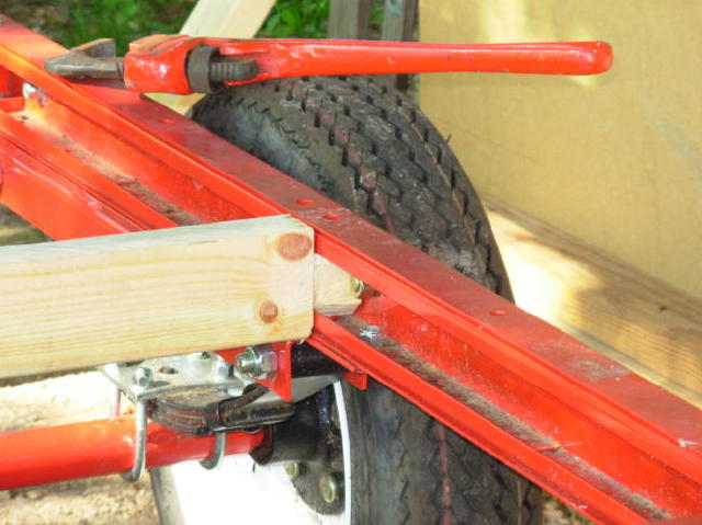

Not sure exactly how the current 1740# HF trailers front & rear chassis sections go together. When I bought my 1740# (variously listed as 1720, 1740, 1800, etc.) in 2006 the chassis assembled in 2 sections & the front & rear sections simply bolted together with 2 or 4 bolts thru the cross pieces, & the spring hanger (a piece of 'u' channel welded to steel angle) bolted to each half, reinforcing the chassis. I just removed the 2 cross pieces that bolt together, slipped 'em inside the 'c' channel side rails. drilled a couple of extra holes & bolted it all together. The 2cross pieces make excellent reinforcing pieces. I then moved the spring hanger mount back approx 4", drilled new holes after 'squaring' the axle to the coupler, & bolted it up. When I was ready to install my 5x9' floor on the 4x8' chassis I substituted a 'fitted' wood 2x4 for the 2 missing crosspieces. Made my maiden voyage in the TD in Sept 2006 & have towed it near 20K miles since with absolutely NO problems with chassis integrity. When I was rear ended Labor Day weekend 2010 my TD survived with little damage to the body & only damage to the chassis was to the rear cross member & 1 stabilizing jack. I credit part of that to the extra rigidity of the chassis side rails with the 'cross piece' inserts.
This is a diagram from HF showing how the 2 chassis sections fit together
Drilling extra holes for the 'cross pieces' nestled (clamped) inside the side rails of the 2 chassis halves, & new holes for he axle spring mount to be moved towards the rear.
Axle spring mount moved back to the rear chassis half (mostly). You can see the extra bolts & if you look carefully you can faintly see the 'butt' joint of the chassis half side rail just in front of the fender nearest the camera
The wood cross member that replaced the 2 metal pieces used in reinforcing the side rails. In the first 2 pix you can easily see the cross members bolted inside the side rails...
