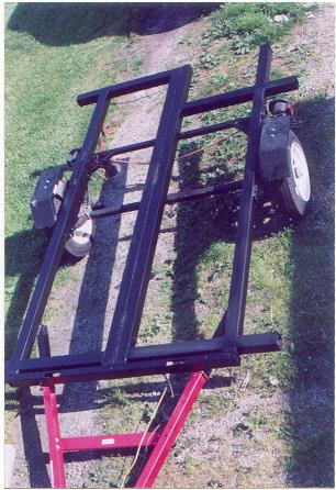

Woodbutcher wrote:Mike ,I scuffed my trailer with 320 grit silicon carbide sandpaper. Then blew it off with compressed air, wiped it all down with Denatured alcohol and painted it with bed liner. Still looks good.
martymcfly wrote:I used Van Sickle gloss black tractor paint. It went on very nice with a roller. It is enamel and looks pretty good.
