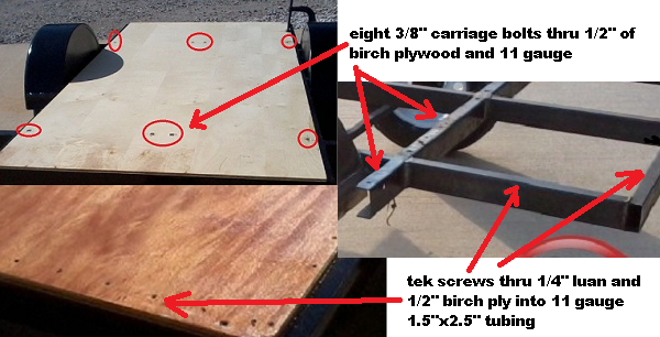

Postby working on it » Sun Apr 23, 2017 10:20 pm
  • Why not use both carriage bolts and Tek screws to attach the flooring? I did, and it was a well-considered choice. The eight 3/8" carriage bolts thru the original c-channel crossmembers will probably exert less hold-down force than the 3 or 4 dozen Teks I used along the floor perimeter, since they penetrate into the stronger rectangular tubing.
    carriage and teks.png (337.88 KiB) Viewed 4713 times
    Teks around the perimeter, adding the most holding power
  • The floor decking was installed in two parts, 1/2" birch plywood bolted down as the base, for strength, and 1/4" luan glued and screwed over it, for its' smoothness and coloration. The carriage bolts were partially sunk into the burch, leaving the heads slightly above the surface plane; the luan sheet added on top was intended to thicken/strengthen the floor, while also covering the partially exposed carriage bolt heads.
  • The carriage bolts, being slightly sunk into the ply, weaken the ply, and would be subject to pull-thru, under high duress situations, and, they were mounted into c-channel, possibly the weakest frame structure. Whereas, the Tek screws are adding more clamping force, holding the decking to the frame, without any weak points in comparison. I've used Teks in race car building, and have never seen any vibrate loose, and the vibrations and stress the Teks have survived is probably greater than a TD or TTT will ever likely encounter. Plus, the Teks are installed into the more rigid perimeter tubing, and are so many in number, that even the improbable loosening of a few Teks, will not jeopardize the deck-to-frame mating.
