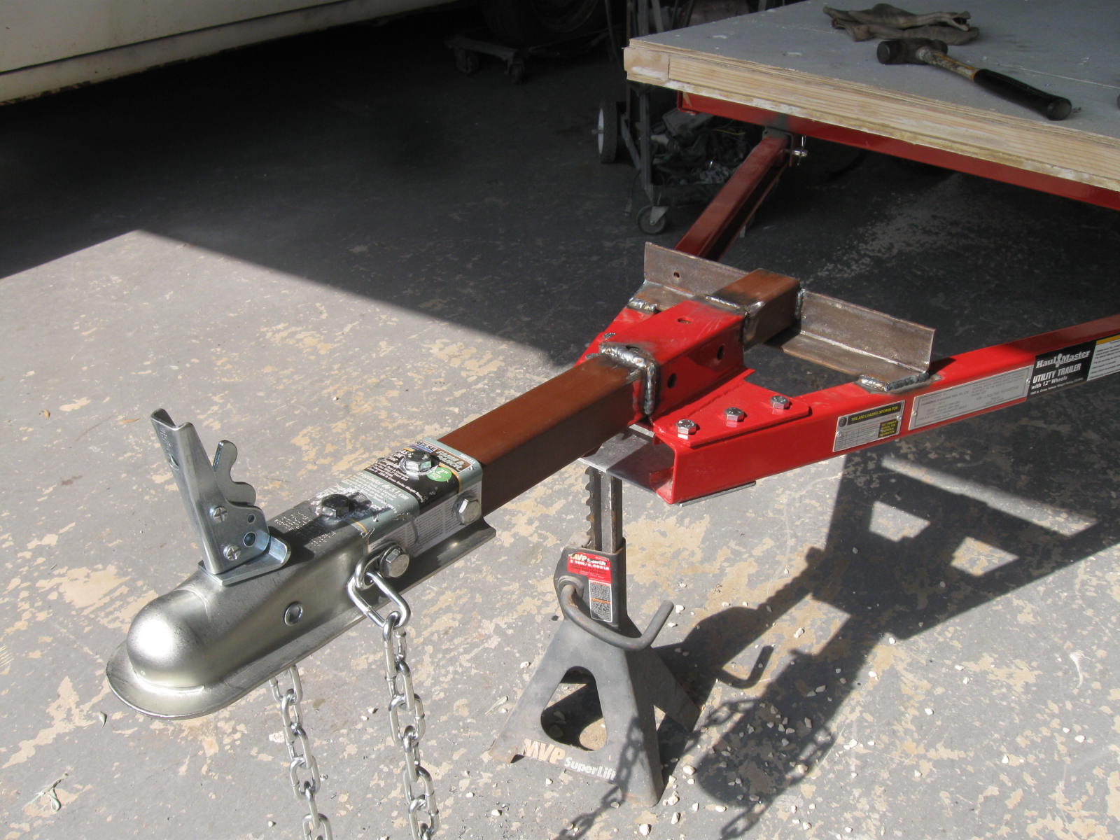

Postby absolutsnwbrdr » Fri Oct 11, 2013 2:00 pm
Why 2.25"?
Go with 2x2 square tube. Flip the harbor freight coupler mounting base plate and slide the square tube through the flipped base plate. Bolt the square tube to the bottom of the first two trailer cross-members, and run a bolt horizontally through the flipped base plate and square tube. Pick up a new coupler for a 2" tongue for less than $25. Solid as can be!

Postby kd5edj63 » Fri Oct 11, 2013 3:31 pm
my ball is mounted dirrectly to my bumper. I have been sipping on a beer and staring at my trailer and I have come up with a few simple ideas that will be less work and keave the coupler at the same height. I found a 2" channel couple at a local hardware store for $20 and I can get 2 feet if 2x2 for $10 :D

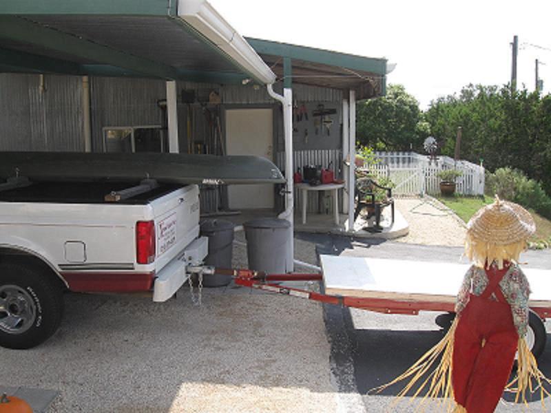

Postby kd5edj63 » Mon Oct 14, 2013 4:20 pm
I got mine done today. the kayak explains the need for the extention

Postby angib » Wed Oct 16, 2013 12:45 pm
kd5edj63 wrote:I got mine done today. the kayak explains the need for the extention
I hope you have factored in that the longer tongue has made the load on it higher but the tongue itself is no stronger where it matters, at the back.
This is no problem if you have a 1000 pound teardrop on a 1800 pound capacity trailer, but you d need to reduce the trailer capacity by maybe a quarter to a third to compensate for the extra tongue length.

Postby KCStudly » Wed Oct 16, 2013 2:51 pm
Another way of saying what Angib said is that by stubbing the tongue extension off onto the 'A' frame members instead of extending the box tubing straight back to the second xmbr... or farther... (like most people do), you have increased the leverage on the existing members without adding any strength. Hence the need to derate.
