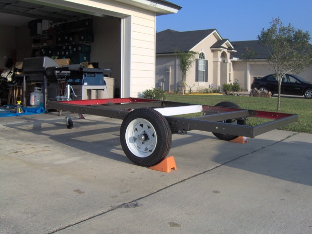

I just want to give my 2 cents worth on the 5X8 Redtrailer now that I finally got time to finish putting it together.
I checked out the trailer from TSC and Harbor Freight before I ordered my tralier. The TSC had the L channel that the floor sits in that I didnt like and it felt flimsy. The HF only makes a 4X8.
The Redtrailer is of better quality than the HF, in my estimation, but if HF made a 5X8 for a better price I would be all over it.
As for the people that dont trust bolt together frames, pull into a truckstop and look at the chassis on any of the tractors....yep, all bolts.
The bottom line is I had to paint over the crappy red paint and change the hitch to one that accepts 2" ball hitch and I ended up with a pretty sturdy trailer.
If I use a store bought frame on my next tear I might use the TSC and use some of the tips that LarryL did to his. He had some good ideas. The TSC has a better axle and 5 lug rims. The best part, its made it the U.S.A.

Postby mikeschn » Sun Mar 19, 2006 6:21 am
Rampage,
I like that 5x8 trailer. If I do another 5x8, I would definitely consider that!
Keep the pictures coming too!
P.S. Got a close up of the axle mounting arrangement?
Postby rampage » Sun Mar 19, 2006 9:07 am
mikeschn wrote:Rampage,
Mike,
I took some pics of the spring hangers after I attached them, but the pics werent on my camera (camera gremelins, I guess). I really wanted to show how I did that. When I get a chance I'll take off a wheel and take another pic.
