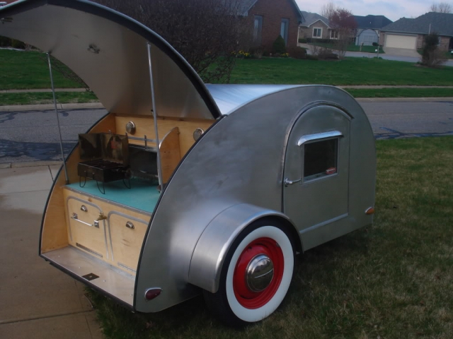

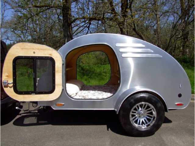

Also, I'd like adorable oversized wheels like these:
or these:

I think you've convinced me to go with the 5' wide, KC.
Though my dad thinks I need to upgrade to a torsion axle anyway--just for added safety. I'm still on the fence about this. I'm using 1/2" plywood exterior walls, and I won't be installing a lot of cabinetry, so based on the various weight estimations on this site, I don't think it's going to be a terribly heavy trailer--I'm thinking 1,100 to 1,200ish, and the trailer's rated for 1,950. And I like that it's supposed to be easy to find parts for a leaf axle, in an emergency. I dunno. Still pondering.
Either way, I'm going to get bigger wheels. Dad (Mr. Safety First) says little wheels are more subject to wear and failure. And, I point out, big tires are cuter! They're safer, he says, sternly. Okay, fine. They're safer. (But they're also cuter.)
Trailer is ordered, Kludge--thanks for the tip! Same price as Northern Tools, plus free shipping!
