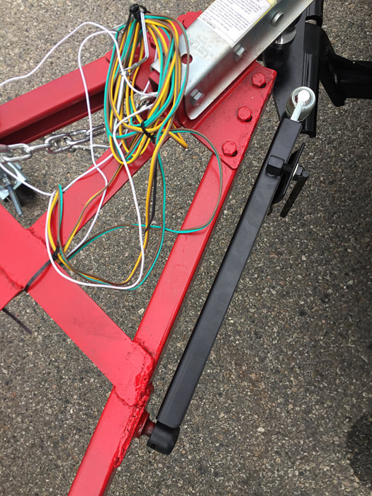

I have the Harbor Freight friction kit on my Harbor Freight trailer. The kit isn't meant for trailers this small, so I had to cut the mounting ball for it to fit the trailer frame and welded it to the frame. The trailer frame is just about 1/2" smaller than the plate for the mounting ball. On the receiver hitch side, I decided to go with the Reece adapter instead of welding it to the receiver hitch. That way I can use the kit on different towing vehicles.

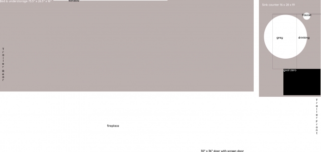

I will just be building the interior and I worry about trucks passing and throwing that lightweight trailer around on my trip from CA to ND to get my DL and vehicle registration and insurance and then traveling around the countryside hopefully on the backroads. when I can't go backroads and have to be on the highways/freeways well that is when I get nervous towing, especially when everyone, including big rigs are flying by me at 75 mph+ It will be level and most of the interior weight will be towards the front. I attached a mockup of my plan for where to put what.. and do not freak cos it says "fireplace"... that is a metal moveable item that can burn gel fuel, denatured alcohol, etc.. and is a candle holder too. It will mostly be for me to use outside to set my stove on. Where it was Grey and Drinking are two 5 gallon water tanks I will be putting in and in the front center inside will be my Goal Zero Yeti 400 energy storage unit. Without the interior, the trailer has a tongue weight of 70 ln and weighs 500 lbs right now, since it is an older Rav4 towing it, and that the trailer has no brakes, cannot go over 600 lbs trailer weight or so Toyota says in the manual.

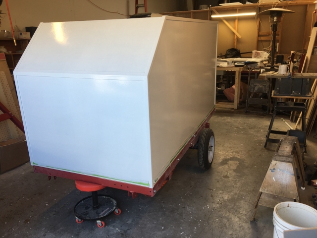

This was before window and door install Image
Plan for interior Image There will be items stored under bed, like clothes and such, nothing while towing will be to rear of wheels though other than builtin bed and storage
