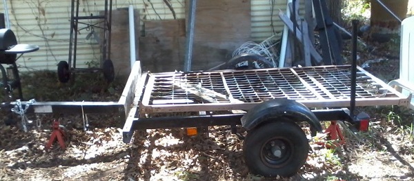

* I started out with a very small 50" x 60" frame, with bent & broken tongue, spindly axle of unknown weight capacity, and 8" wheels & tires.
twin-bed frame laying on trailer for size comparison
original frame with 8 inch wheels.jpg (90.34 KiB) Viewed 4434 times

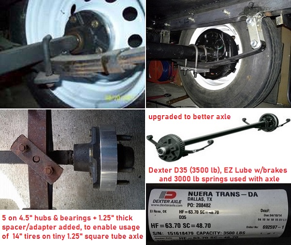

I knew that I had to upgrade everything, but gradually, as my budget might increase (it was started with no budget at all). So, I added only what was needed to get it operable, and the wheel size was first to get attention. My wife's business trailer had 14" wheels, and a brand new spare, so that's what I chose (I carried that spare for 6 years, until I upgraded to LT tires). Like Vtec44, I used a hub/bearing kit from Northern Tool (probably the same one as shown), and added two discarded ST tires I was given. After the frame was enlarged to 50" x 97.5", I added spacer/adapters to gain some side clearance for the 14" tires. That was the way it was for the first few years: using a sketchy axle, old/repaired tires, and definitely taking chances with the absolutely overloaded set-up.
* After a spring hanger tore loose, I decided it was time to upgrade the suspension, so I reinforced the frame, and added all new axle, springs, & associated hardware.
old & new axles.jpg (131.7 KiB) Viewed 4434 times
It was quite a relief knowing that the axle wouldn't snap in half, or the modified spindles would let go, but I still used the aged tires for another 3 years. Now, with practically bulletproof (as opposed to 12 year old may-pop ST tires) LT tires, the trailer can handle its' weight growth to 2200 lbs, and rough roads (or trails?), without constant worry about the rolling stock giving out. I wish I had made the upgrades at the very beginning!
