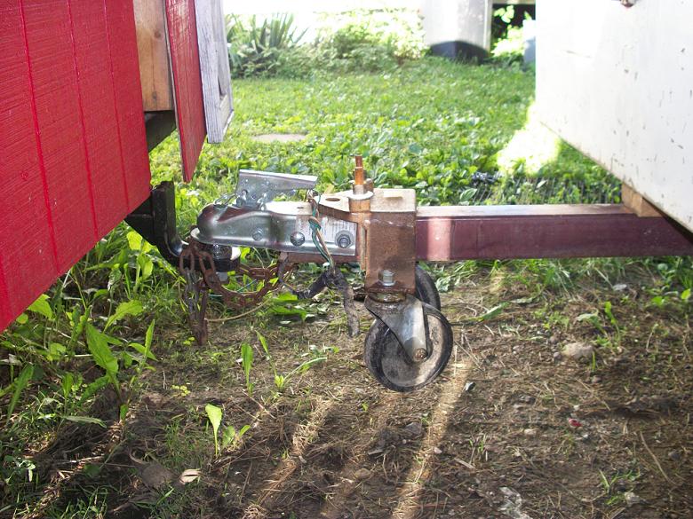

I think it's fine, other than maybe a little overkill using square tubing on the cross member above the axle. (But I'm not an engineer –-you must have a reason for that. )
As someone else said, add some tabs for cabin attachment. You might consider a removable coupler for security:
:thinking:

Tony, I have had your build journal bookmarked for a while now and was strongly influenced by your design :). I find that removable coupler an excellent idea. Is there anything you would change in your design looking back on it?
Thanks again for the feedback, and happy new year!
There isn't. It evolved from the previous three builds and 17 years of teardropping. :thumbsup:
