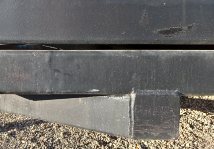

Postby working on it » Sat Oct 21, 2023 10:49 am
I have a single-beam tongue on mine, 72" x 3" square tube, .188 thick. It is attached under the plane of the frame, to three cross-members and a central spine (butt-welded inside the frame). The tongue is sistered to the spine, for extra strength and rigidity.
tongue attached to spine.jpg (359.22 KiB) Viewed 1942 times
173193172890148599
