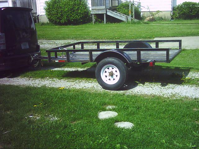

There are trailer bargains elsewhere... I picked up this one used for $250.00 and simply sawed off the side rails where I didn't want them.
