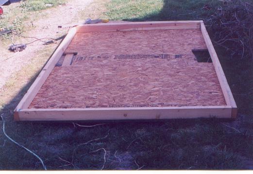

Postby bobhenry » Mon Nov 19, 2007 8:59 am
I went over the wheels. I screwed and glued 2x4 perimeter around the osb floor that lays directly on the frame. The 1/2 osb sides were screwed into the 2x4 and a 1x4 cleat is added inside to help with the wall load and act as a nailer for the 1/4 luan interiorImage
