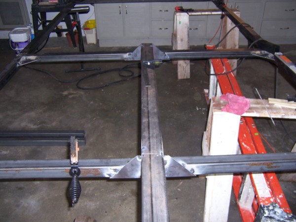

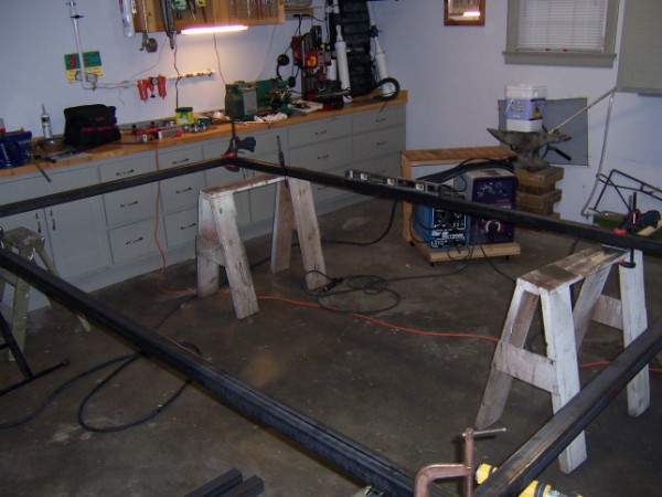

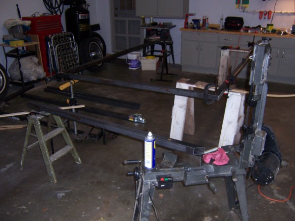

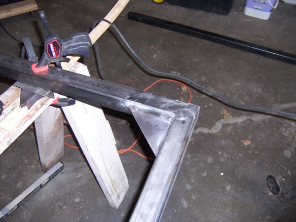

I have went and did it. Got some metal finally and started to make a general mess of the garage. It takes a project like this to find out that your HF band saw doesn't really cut all that great and you need more clamps than you have on hand. Don't know what I would have done without my Dewalt 4 inch grinder However, the desire to build can over come most of these problems. I'm using my Hobart Stickmate stick welder to weld with and seems to be doing well. Here is a picture of the start.
I'm just getting things tacked in and checking for squareness. I was going to set up my laser today and check for level one more time to verify the bubble levels before I finish the welding. BTW, Warner Steel in Indianapolis is a great place to buy your metal needs. A small one man shop that let's you look around and will cut your metal to your request.

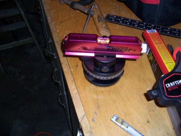

Postby Tom7707 » Thu Jul 02, 2009 1:34 pm
Gang,

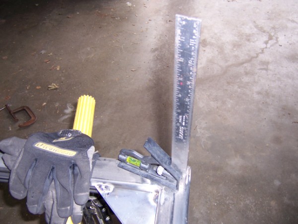

Here is how I checked the bubble levels with my laser. I just set my laser up on the bench and used a square to use as a reference to see how level the frame was. You can see the dot on the scale. Mine was off about 1/16" to 3/23" of being level at all corners. In my world that close enough.
It will be Friday before I get the axle mounted. Nice to be off this week.
:thumbsup: Tom

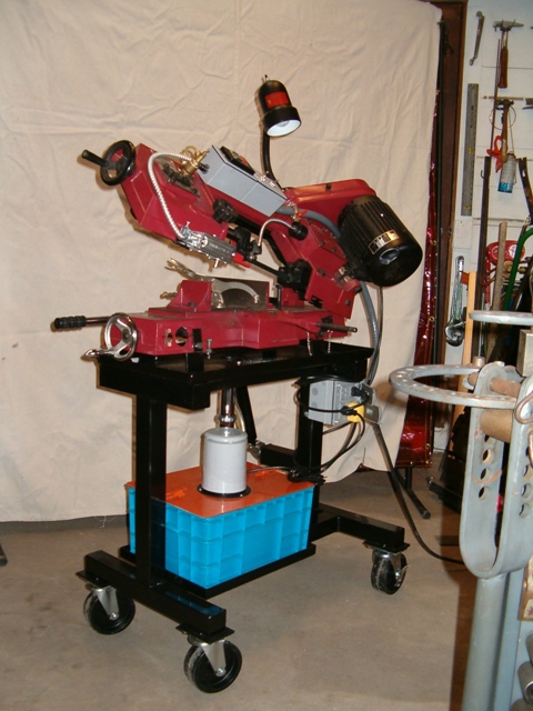

Those Horror Fright bandsaws can use a bit of a tune up when you get them. Besides a good alignment, I have made several mods to mine, but if you look carefully you can still find the HF in there somewhere;
