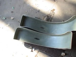

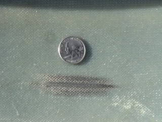

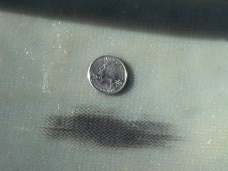

Took my fenders ( a pair of Grants 12" fenders) and found where the tires have kissed the under side of the fenders.
Don't really want to have to drill new holes, and I mounted the axle on top of the springs. SO I was thinking of putting some 1/2 steel between the spring mounts and frame. Would this work? Any other thoughts?
Thanks
Aaron
