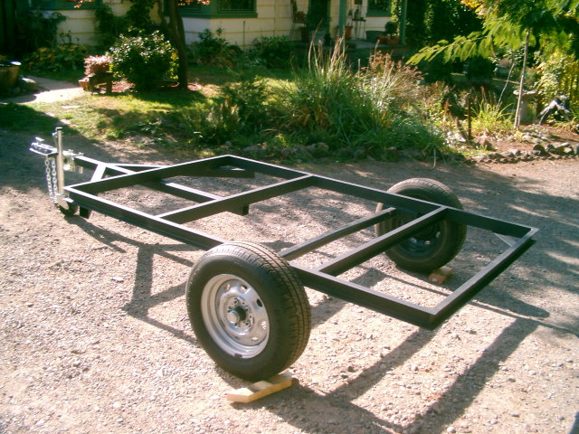

Hi All,
Well, I got the Frame Done! :D
I'm hoping to get some temp lights on it and take the trailer out to see how it pulls and to get the 5 by 8 plywood for the deck tomorrow!
-phil

Postby SkipperSue » Fri Oct 13, 2006 9:08 pm
Looks nice Phil! :thumbsup: What size tires are on there?

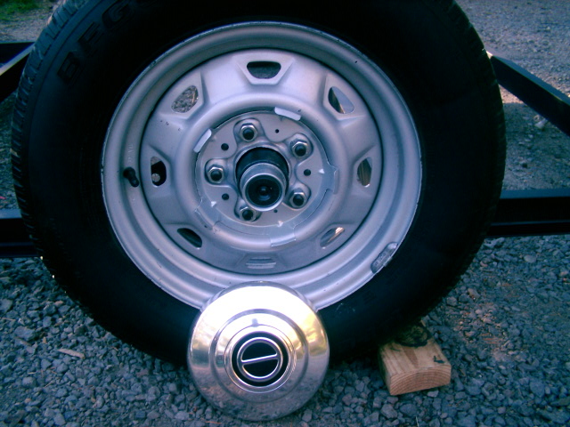

Postby cablerunners » Sat Oct 14, 2006 7:55 am
Thanks Guys!
Right now my main concern is that it doesn't fishtale down the road :worship:
The tires are 185 75 14.
The wheels came with center caps that I liked, but they don't fit with the hub dust covers on...
I may try baby moons if I can find some that fit. :)

Postby Nitetimes » Sat Oct 14, 2006 9:03 am
You could always find a punch or hole saw just a bit bigger than your dust cap and punch a hole in the hub cap so the dust cap can stick thru. :thinking:

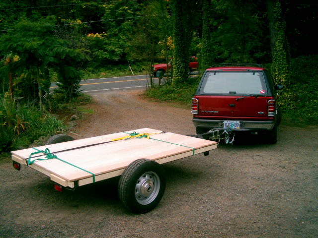

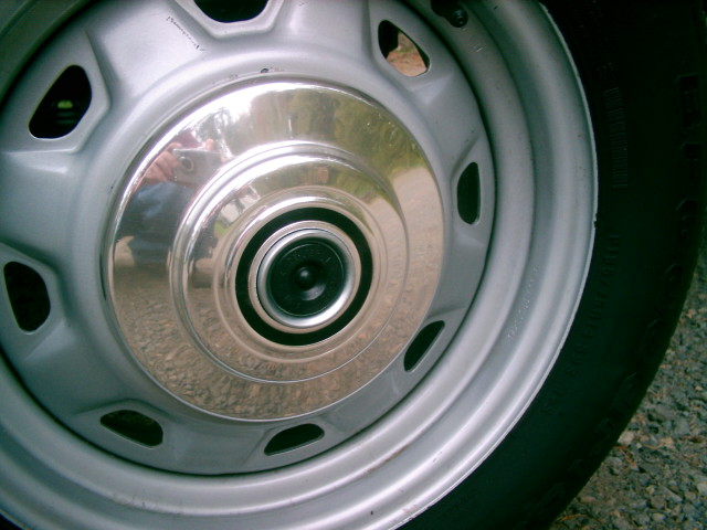

Postby cablerunners » Sat Oct 14, 2006 6:04 pm
On my way to the lumber yard, a lady rearended my trailer while waiting at a light! It was a good bump. Enough to make me hollar "What the @#$!" Anyhow, no damage done... geeze. :o
It towed like a champ! Hardly knew it was back there!
Rich, I owe you a beer! Take a look a the cut out hub cap. A great idea you had there. Thanks! :applause:

Postby mikeschn » Sat Oct 14, 2006 7:36 pm
Yea, that was a good idea... That hubcap looks sharp with the cutout.
Postby Nitetimes » Sat Oct 14, 2006 8:17 pm
-phil
Glad it worked for you. Nice job on the cutout too. Looks like it was made that way.

Postby doug hodder » Sat Oct 14, 2006 8:20 pm
No kiddin'...that appears to be factory!!! Good idea Rich and good execution on it Phil!!...Doug
Postby SkipperSue » Sat Oct 14, 2006 10:11 pm
That hubcap shore is purtty! :thumbsup: :R :applause:

Custom? Kit? Torsion axle?
Postby cuyeda » Sun Oct 15, 2006 1:10 am
Phil nice job on the trailer! It's looks so clean, it must be a custom trailer. Did you build it yourself, or is it a kit? I don't see any springs in the picture, so it must be a torsion axle. Judging from the 5 x8 wood loaded on it, is it a 5 x 8 finished trailer dimension? What design shape/dimension will you build on it?

Postby cablerunners » Sun Oct 15, 2006 9:50 am
Hi All,

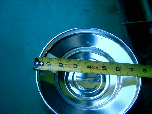

Thanks! I am happy how the Hubcap turned out. I happened to have a holepunch "knockout" set and one size was really close to the dust cap diameter. I also had a grinding stone for a drill that was a tad bigger and there you have it.
Hi Cuyeda,
Thanks! The trailer is made from scratch.
I was going to have a trailer builder build me one, but he went AOL after giving me a great price. (hmmm under bid?)
I got the steel from a steel yard and they cut the 45 degree angles and the lengths I needed. I went there set on 2x2 tube for the frame, but the yard worker talked me into 3" channel instead. His reason was that there is about the same amout of steel in both but the 3" channel is "stiffer" down the length and less likely to refect road vibrations along the length... (Hope I relayed that okay).
The tongue is 2.5 x 2.5 tube steel. All pieces are 1/8" thick.
Anyhow, I rented an ARC welder for $27.50 for a day and welded up most the frame that day. I also rented an angle grinder $17.50 a day and a long extension cord for the ARC welder for $15.00 a day (all said and done it cost me $60.00 in rental). Later, I decided to buy a used ARC welder for $80.00 since I had more welding to do.
You're right it is a torsion axle at 45 degrees. Probably the only thing I'd do different so far, it get a 22.5 degree axle. The trailer would sit a bit lower then. I think the hight of ours is fine though.
Cost: Steel $220.00; Axle $185.00; Wheels and Tires $100.00; Coupler, Jack and Chains $80.00; temp Lighting $20.00 = $605.00
This is not counting rental and other needed goodies.
