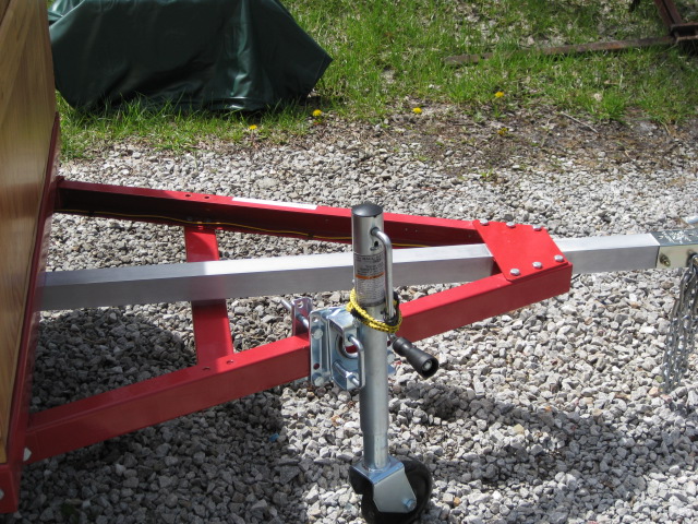

Postby bobhenry » Sat Apr 04, 2009 5:15 am
That same problem is what has me worried about the overall strength of the HF tongue setup.
Here is my intended improvement thanks to " Nobody"

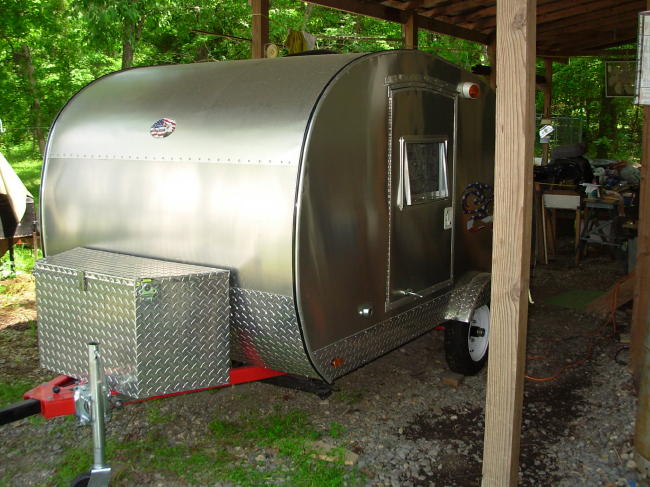

Postby Nobody » Sat Apr 04, 2009 9:06 am
When I had the jack in that position it was absolutely stable with the tongue modification. I've since moved the jack as far forward as possible on the "A" frame member to accomodate my tongue box. Still very stable with no flex whatever in the frame. Can't say the same about the jack tho; the swivel mechanism has begun to 'wear' after 3yrs of use & allows the jack itself to 'wobble' a little :roll: , which makes me awfully glad I installed the 4 corner stabilizers ;)

Postby bobhenry » Mon Apr 06, 2009 2:00 pm
Damn Harv. you do nice work that is a beautiful tear

Postby Toytaco2 » Mon Apr 06, 2009 3:08 pm
buckethat, my HF frame is the heavier duty 1,740lb model and the tongue twists when using the jack just like yours does. I'm planning on doing the same modification that is shown in the pictures in the last post. It looks fairly simple and should be quick to do.

Postby Nobody » Mon Apr 06, 2009 8:59 pm
Thanks BH, coming from the creator of the 'moon roof' that is indeed a compliment ;) :D

Postby Toytaco2 » Thu Apr 09, 2009 11:36 am
Harvey, did you simply turn the original coupler mount on the HF trailer over and use it as a sort of "cradle" for the 2 inch tubing/extension? Was a new coupler required to fit the tubing or were you able to reuse the HF original?

Postby Nobody » Thu Apr 09, 2009 3:12 pm
Toytaco2 wrote:Harvey, did you simply turn the original coupler mount on the HF trailer over and use it as a sort of "cradle" for the 2 inch tubing/extension? Was a new coupler required to fit the tubing or were you able to reuse the HF original?
Thanks,
Mike
That's exactly what I did Mike. I did have to do a little judicious grinding on the inside ends of the 'A' frame members so the tube 'receptacle' would fit between them in order to insert the new tongue tube. I didn't use the 'factory' coupler as it was made to fit over the original 2 1/2"(?) P.O.S. mount. I bought a coupler (Wal Mart I think, or maybe Tractor Supply?? :thinking: ) to fit the 2x2" tubing & just bolted it on. That also made for easy fastening of the safety chains. Wuz also able to use a plastic 'loom' & run the trailer connector wiring inside the tongue tube. I like that better'n trying to 'contain' it inside the 'C' channel frame (tho I had to do that from 2nd cross member on back to tail/signal/running lights).

Postby Toytaco2 » Thu Apr 09, 2009 3:34 pm
Harvey, could you indulge one more question: Could this whole project be done with a drill and bolts, or does it need to be welded up (I'm thinking now mainly about the angle iron attached to the tube)?

Postby Nobody » Thu Apr 09, 2009 10:17 pm
Toytaco2 wrote:Harvey, could you indulge one more question: Could this whole project be done with a drill and bolts, or does it need to be welded up (I'm thinking now mainly about the angle iron attached to the tube)?
Thanks,
Mike
Mine is all bolted. I bolted the angle iron to the underside of cross members #1 & 2 (after clamping everything in place & 'squaring' the coupler to the ends of the axle spindles). The new tongue is bolted (crosswise) to the angle iron (2 bolts) & vertically thru the old coupler & bottom brace. I used 1/2" grade 5 automotive strength bolts & am well pleased with the result :thumbsup: . Oh yeah, I did use my old 1/2" commercial grade drill; I'm not sure I could've done it with the little 3/8" variable speed drill & reduced shank bits :roll: . The angle iron came from old bed rails & they were HAARRRD! I pre-drilled the holes in them on my drill press & then finished up using the 1/2" drill on the trailer frame & tongue once everything was aligned/clamped in place. Was actually easier to do than describe (for me anyway ;) )

Postby TimJones » Sat Apr 11, 2009 1:53 pm
Spent the day working on my tongue. Thanks to Nobody for the idea and bobhenry for getting me started. Sure looks better now, doesn't take long to do Just getting started is the hard part.
