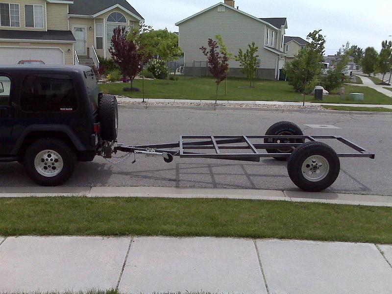

Should I use an a-frame jack in the a-frame coupler or a folding jack on one of the tongue rails? :thinking:
My (hopefully soon to be complete) frame will have an a-frame tongue with a ground clearance of around 12-13 inches. On a lot utility trailers I've seen, the jacks in the a-frame coupler are bent back. I have concerns that an a-frame jack may drag also. Your thoughts are appreciated.

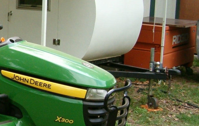

I welded a plate on the tongue of my Harbor Freight trailer to make an a frame jack possible. The first jack I put on there worked fine but the wheel had to be removed to provide a comfortable level of clearance when raised, so I ended up with the jack in the picture. It has a rack and pinion for raising and lowering with the side crank handle and the wheel retracts all the way up to the base at the top of the rails. The diameter of the wheel is larger than the height of the rails so part of the wheel is still exposed when full retracted but there is plenty of clearance. You would almost be dragging the hitch before you could drag the wheel. This type of jack is a little more expensive than the top crank, enclosed shaft type, I've seen it used mostly on horse trailers, and found mine at Tractor Supply. The draw bar with ball partially blocks the view in the attached pic but it is the best I could find tonight. I also have an a frame jack on my flat bed trailer with a simple plate rather than a wheel and have never bent the jack. My brother in law bent the jack on his trailer but it was due to not fully retracting the jack before towing the trailer.

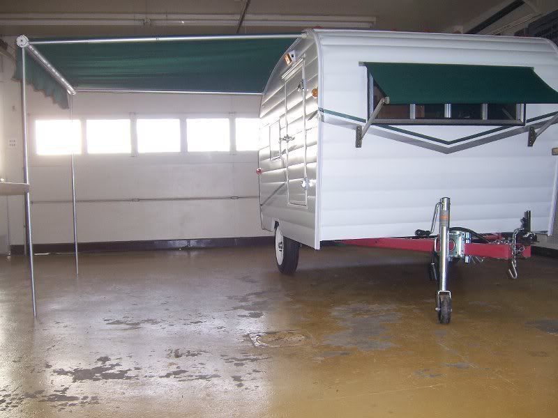

On a frame I built last year and one I'm working on now I chose an A frame jack. I wouldn't want one mounted in the coupler because the tow vehicle is a pickup and I couldn't put the gate down. With the composite tongue the jack moves rearward and it's not a problem.

The HF trailer in my pics is for parts hauling. My teardrop frame will be made out of 2x2 square tubing with a welded a-frame coupler. My axle is a Dexter #9 with a 10 degree up angle. I don't have my wheels and tires yet (or frame for that matter), but figure on a clearance of about 12" at the bottom of the a-frame. I prefer the bolt in a-frame jack and don't mind taking the foot or wheel on or off, so that is the way I'll go.
