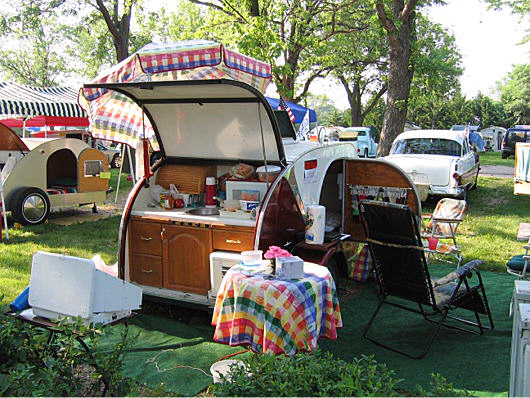

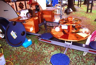

Postby bobhenry » Mon Jul 06, 2009 1:26 pm
Got Ol' Bitty's in my album.
God bless Marge :thumbsup:
Postby Ron Dickey » Wed Jul 08, 2009 8:26 pm
whow.... :thumbsup: nice
I had heard about your spare but had not seen it till now. 8)
I was thinking of just putting a 2x4 across the back and attaching a gate hinge on one side and a 2nd 2x4 infront of the first and attaching a Vertical wood piece to that in the middle and attaching the tire to that. But it offer no function other from locking the hatch and offering a place for a 3rd brake light to be seen.
I know a welder who could fabracate something like that for me. Not sure of cost though. How long did it take to design that??
Met a man in Northern Cal. at the Shasta Gathering who had a round table that swung out with seats for one to sit at but it was not for his spare.
Thanks that opens up my world. :thumbsup:

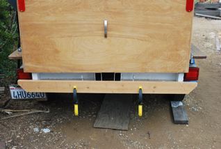

Postby Ron Dickey » Sun Jul 26, 2009 11:58 pm
I am very thankful to you for you offerings of ideas.
I think I have figured out how to do it in wood.
I cut a bumper out for starts it sticks out a little on the sides so in so backing it will protect the rear trail lights. My hatch was out farther then the bumper area so if hit it would get the total wham. So now I have a 2x4 ready for a second one that will hold the tire and opening hing.
I painted the bumper semi glossy white. I am ready for the next step.

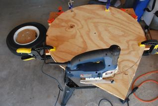

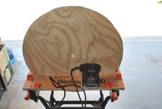

I cut the top of the table today I am not super skilled but I drew a line and cut it with my jig saw I might follow with a router or just sand out the kinks.

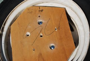

Postby godskid » Thu Jul 30, 2009 5:29 pm
Yes, pics please. I can understand pic3 above, but as a city gal I'm not familiar with what you are calling a pin and eye ranch gate! I'm not sure about how the tire switches from one position to the other. Thx!
Also, I don't know where to GET the thing in pic3.

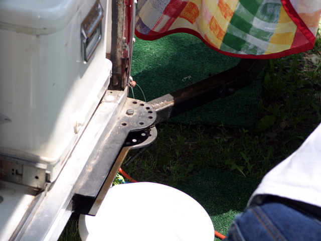

The lock plate in pic 3 is made cut out of iron or wood it just keeps it from closing.

Postby godskid » Thu Jul 30, 2009 7:29 pm
bobhenry wrote:Got Ol' Bitty's in my album.
Actually, your drawing makes sense! (Once I printed it and got it to full size, for readability).

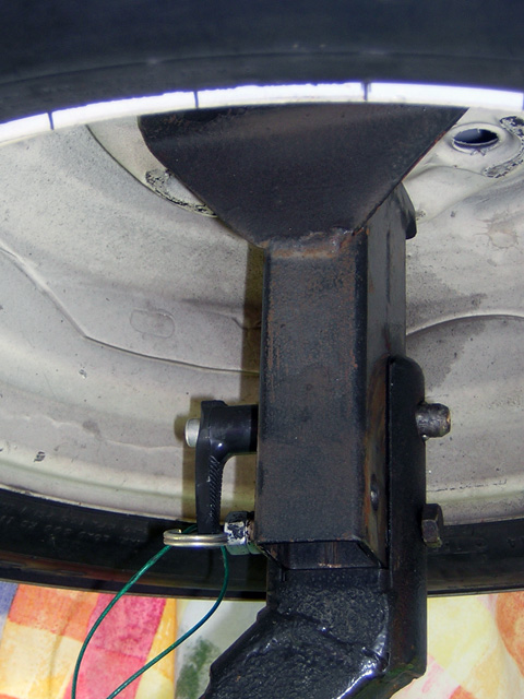

I was just hoping the gadget in the above pic was purchase-able somewhere. It looks a little stronger than a door hinge (but hey, I don't really know anything about it!)
I also need a diagram or verbal explanation of the above connection, cuz I'm not quite following how to affix the tire in one position or the other. Does it just hinge into both positions? Or do I lift the tire off, and re-insert the support post into the connectore in the other position? (groan...)
Deb

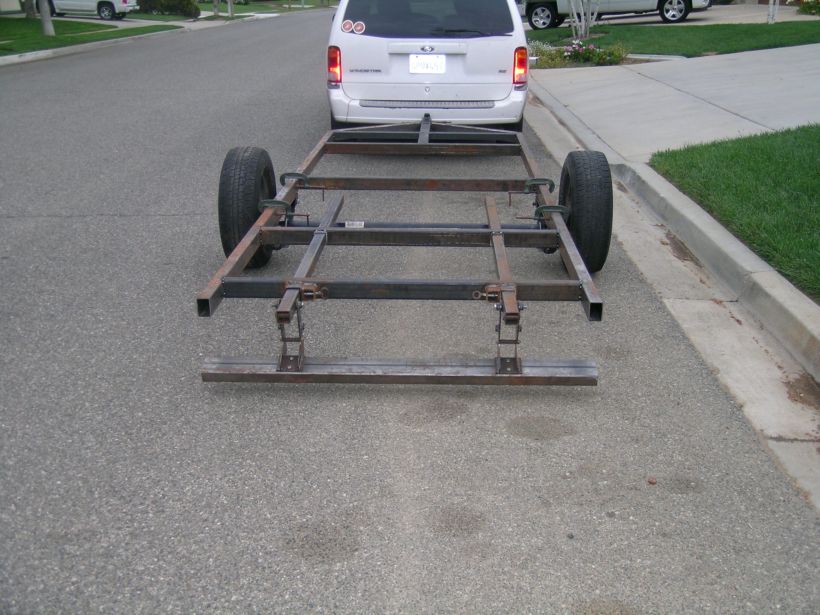

I made a bumper that will bring the bottom of the trailer forward. My hatch stuck out to much and I realized if I got hit it was a goner.
I used carrage boltes attaching it to the frame Painting it before hand with semi Glossy paint.

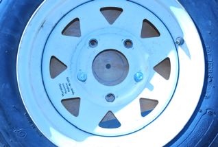

I attached a scrap peice of wood to the back of the wheel so if I had a flat I would siimply remove the tire from the unit and then place the flat tire back in place of it.
the side you would see if there was not table top. (infact If I had not spare tire I could in fact still have a useful table.)

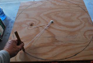

I found some more scrap wood left over from my build. drilled a hole in the dead center, found by making an x running diagonally from each corner.
Then stuck in the bolt and attached a string to it and a pencel. and drew a circle. to cut out I made it 2 inches larger then the tire, so if I made some bad buts I would not have to strart over.
I used my jig saw to cut it. Other members should have some better ideas of how to do this part.
this is how the table top came out a little rough, I have a freind who has a belt sander that works well on curves. I should have cut it with my dremel or router. I filled in the cracks with wood puddy and will sand it out later then paint it with glossy or semi glossy paint.
