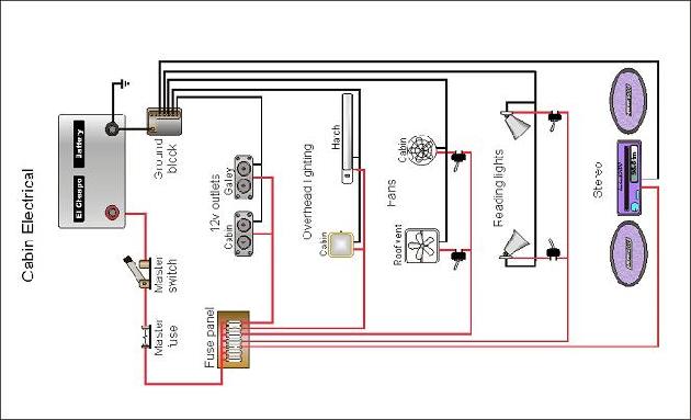

Postby bobhenry » Wed Sep 02, 2009 6:08 pm
Where is the adventure in that ?
I melted several feet of wire and learned real quick how to do it right.
We're here we will help!
My mistake was being to cheap to but the right gage of wire I knew better but ya gotta experiment.
Here is a 12 volt wiring diagram from Joanne that helped me a bunch......
