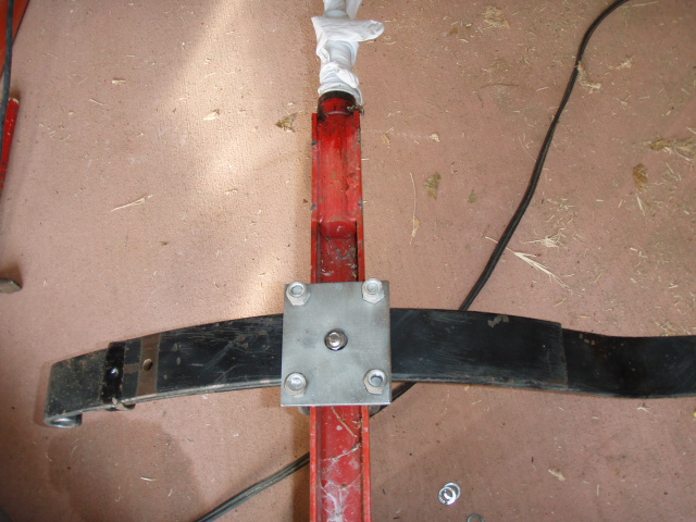

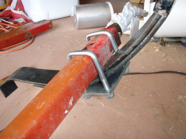

Postby RogHodge » Fri Nov 13, 2009 6:08 pm
Okay here is before and after? Does this look like the correct parts order?
I will need to grind the spring indexing bolt to fit against the axle.
For those who would like to have a look I have a build journal and covet your feedback.
http://www.tnttt.com/viewtopic.php?t=33547
RogHodge
Posts: 279
Images: 51
Joined: Mon Jan 05, 2009 12:24 am
Location: El Cajon CA- east of San Diego
Postby madjack » Fri Nov 13, 2009 6:20 pm
Rog, that hole and indexing bolt does more than located the axle, it also keeps it from moving once bolted up...I wouldn't just grind the bolt off but drill a hole for it to fit into...sorry for being late to this thread but I have not previously messed with a HF trailer............

Postby hugh » Fri Nov 13, 2009 8:49 pm
I have been staring at your before and after pictures and something strikes me as wrong. When the spring is mounted on top of the axle the U bolt plate sits flush on top of the spring plus the locating pin goes through the spring and into both the axle and the spring plate which helps keep the spring from moving sideways. That looks like a slipper spring which is located by the shackle and the pin in the center. The frame appears to be a channel, if it is I guess it would keep the slipper end of the spring aligned also.
When you moved your axle under the spring it looks like the arch of the spring does not allow the spring plate to sit flat plus you no longer have a locating pin to keep the spring in line. Looks like a very real chance of the spring being able to move sideways. It,s hard to tell from a couple of pictures but don,t be cheap on the important stuff.

Postby RogHodge » Sat Nov 14, 2009 10:05 am
To allay your fears let me assure you that I won’t do anything foolhardy or dangerous. :phew: There will be a hole to both keep the springs from wandering and allow everything to be snugged up. In my haste to post a picture I didn’t tighten the u-bolts.

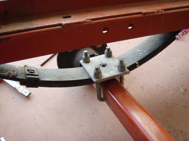

Postby RogHodge » Sat Nov 14, 2009 2:24 pm
I tried my idea with a stunt bolt (he volunteered for service)- I am now convinced intellectually and experientially that I need a bigger drill- (save the jokes)
I guess I’m off to HF – I hope their POS bit is good for two holes.

Postby satch » Sat Nov 14, 2009 2:30 pm
Looks like a winner to me.

Postby hugh » Sat Nov 14, 2009 5:12 pm
looks good now.
