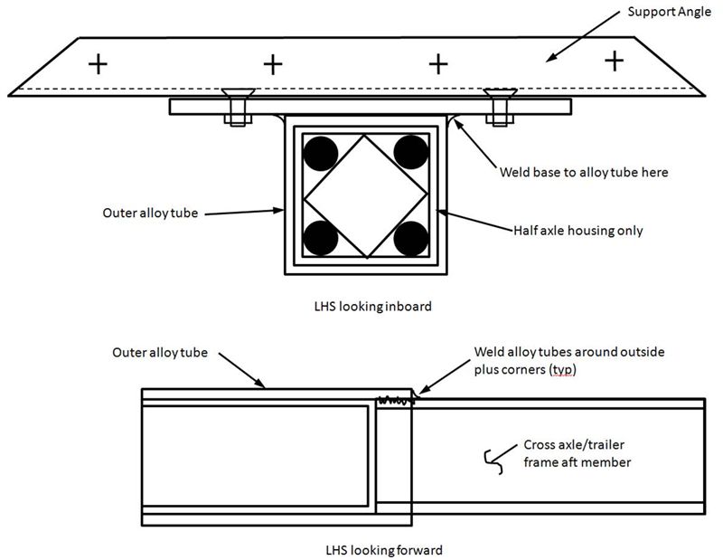

Sorry, I really can't understand the channel description - I think a sketch is needed.
Aligning half-axles is really not difficult - it's really no harder than putting a full axle on straight. The trick is not to try to align the mounting bolt holes but to bolt the half-axles to the mouting plates, align that assembly to the trailer frame and then tack wled the mounting plates to the frame. Putting a straight-edge across each hub and making sure they are parallel is all that is needed. Talk of toe-in and toe-out is for cars with delicate steering setup - this is a trailer and it just isn't that sensitive.

angib wrote:Sorry, I really can't understand the channel description - I think a sketch is needed. Andrew
Please see that attached sketch – I hope that’s a bit clearer than the words. It would only be on the outboard 2 rows of fasteners. As you know, it’s rare that an engineer can have much of a conversation sans paper and pencil! Also, note that I changed the channel to angles because I realised they don't apparently make channels in that size (who would have thunk it?).

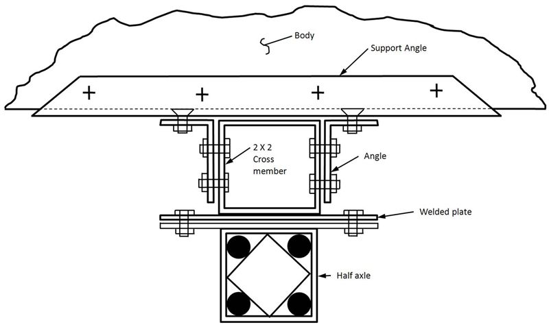

Postby kennyrayandersen » Tue Jun 15, 2010 1:35 am
So I was wondering if the half axles could be got sans the mounting flange. Then you could jam it in an alloy tube, which could act as the axle and a pre-welded flange on the tube would allow it to be mounted to the angle support. You could even nest the center axle into the alloy outer tube if the size of the tube where the half axle inserts was too large.
See attached diagram below
I suppose you could do the same [and maybe easier] if you were to use a steel frame. What does it buy you? Less weight and 2 inches lower to the ground and I think a little better axle to body/frame attachment.
Possible?

Postby angib » Tue Jun 15, 2010 12:59 pm
The fly in the ointment (does that expression exist in the US?) is that the Flexiride half-axles under 1400lb capacity aren't square but have a sorta semi-circular section, so removing the flanges doesn't help.
http://www.ucfamerica.com/tech.html
I don't think ordering without flanges is needed - just cut them off with a grinder (with plenty of water to keep the rubber cool).

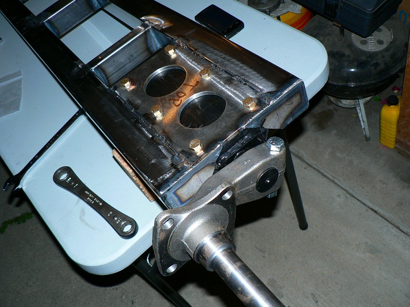

The Dexter can be "de-rated", yes. Although I'm not quite clear on your question (italicized), as far as I know, the Dexter axle is the rubber stuffed [sic] into each end of a square tube...
Have you seen my version of a half-axle mounting plate crossmember? It gets the half axle up there without too much hassle... (although scratchbuilding a chassis doesn't go quickly, especially when working with others' schedules; people like welders. Good welders...)
http://tnttt.com/album_ ... c_id=66058
http://tnttt.com/album_ ... c_id=66057
http://tnttt.com/album_ ... c_id=65436

Hmmm, Well I was trying to keep it really light-weight and am trying to somehow work in an alloy chassis. I’m not sure it can be done, but I’m digging.
I guess what I was talking about was the Dexter full axle, which I think can be de-rated. I was wondering if it was possible to swap out the steel axle (which is really more of a support beam) for an alloy one. If it’s mechanically attached (fasteners) then it would be possible. If it’’s welded, it would be harder (though maybe not impossible). Ideally, what I really want is just a square torsion housing that could be stuck in the end of a square alloy tube. The Flexirides look like it wouldn’t be so easy to do that since it ain’t square in the size I’m looking at. I think the picture in the Amazon add is wrong – someone got lazy and pasted the one pic for all of the different axles figuring no one would notice or care – how wrong they were!
